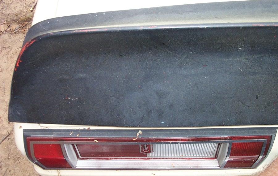

I picked up a one piece factory rear spoiler for my 80 Volare Duster.
Can some one take a pick of the inside of the trunk where the spoiler mounts.
There are no holes in my trunk where you can put a socket on an extension and reach the bolts.
I'm thinking they had 2 trunk lids, one for spoiler and one for non spoiler,
a pic would solve that mystery.
I need help on how to mount this thing correctly.
or do I just find a trunk lid that already had a spoiler?

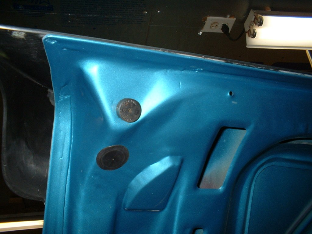

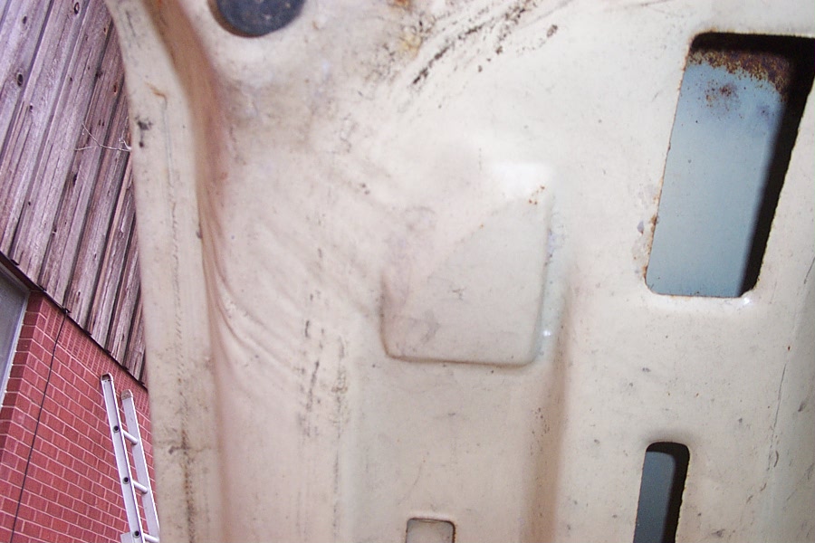

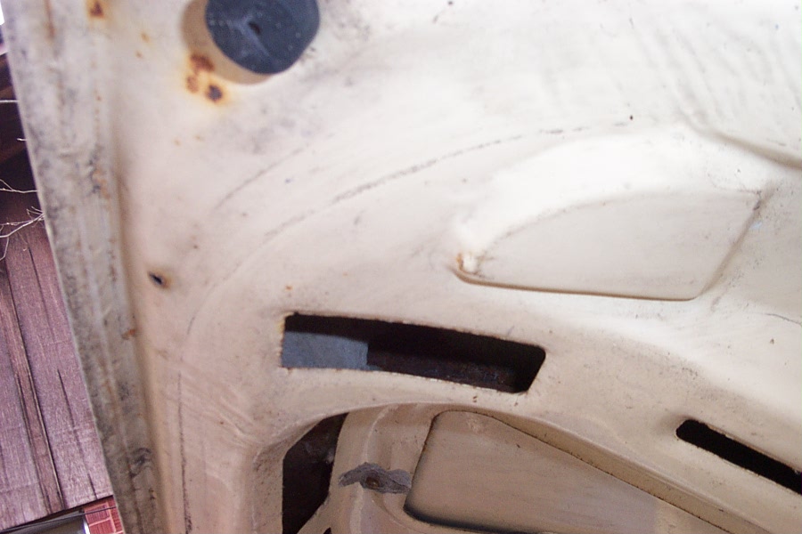

For what it's worth, here's pics of my lid with the one piece spoiler. It did NOT have a spoiler stock. I drilled access holes (1" I think) for the outer bolts (with the plugs in the pic). The inner ones I accessed through the big holes in the inner structure.

Thanks 500!
The end holes are the ones I was wondering about.
I have a hole saw bit set.

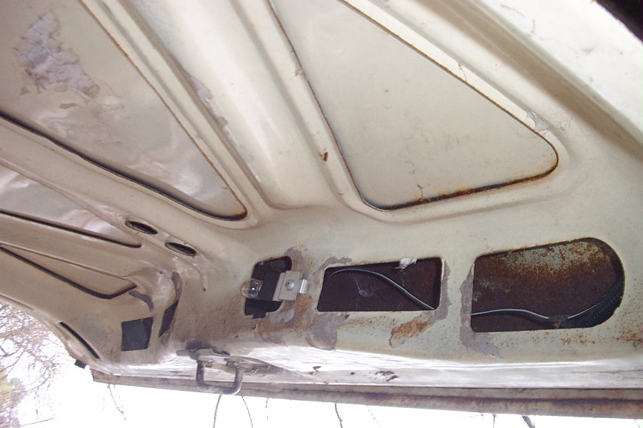

I would still like to see pics of a factory spoiler inside trunk lid.
500, How did you know where to drill the holes?
Did you use a paper template from another trunk lid?

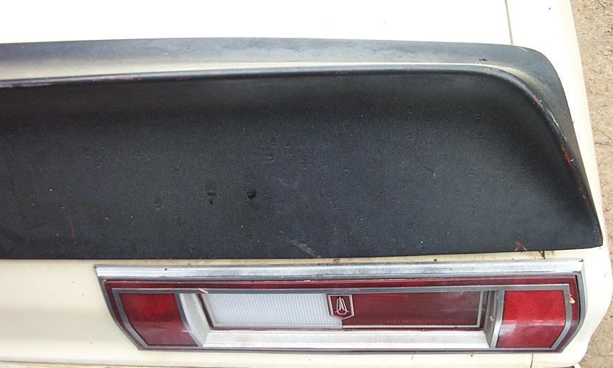

If I have to drill the holes I will.
I would like to find a trunk lid thats already drilled,
because mine has some spots of rust coming through in the upper corners.
But it would have to be close, because shipping for this large item would be killer.

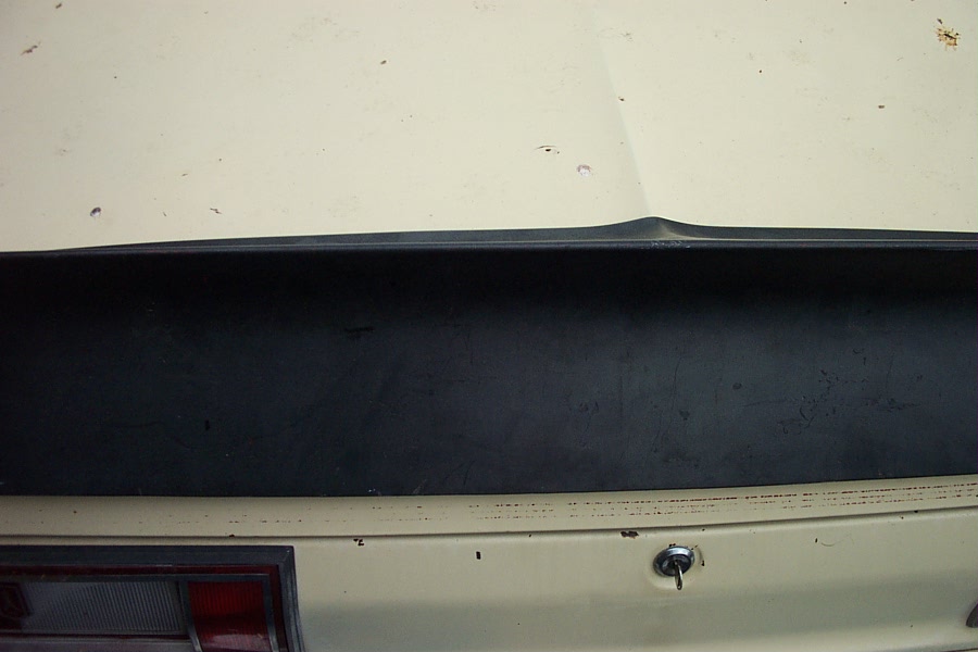

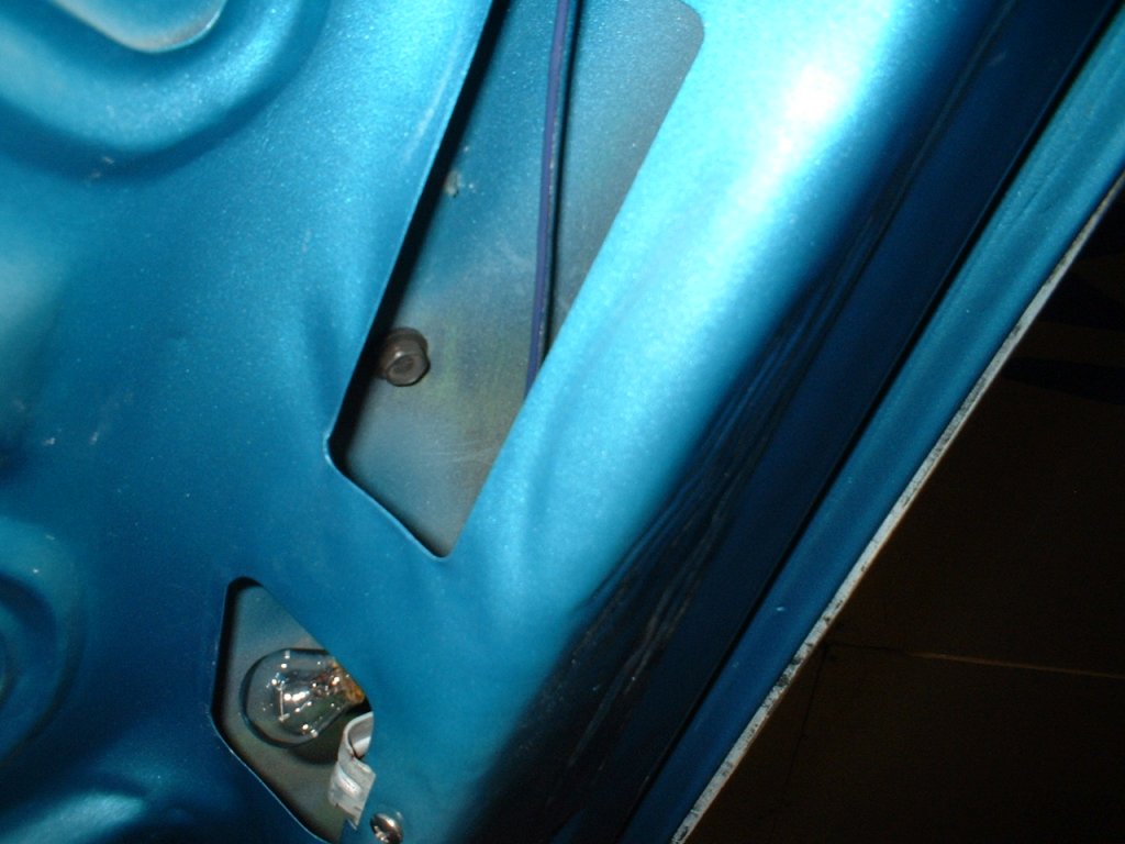

I'm just holding the spoiler in place for the pics, so it wouldn't slide off.

My lid had a little rot through in the lower corners too, both inner and outer panels. You can kind of tell by the way the seam looks a little funky in the corner, lol.
It was so long ago that I added the spoiler (like 25 years ago), but I probably took some careful measurements of the spoiler and transferred them to the deck lid and added in a bit of luck. Honestly, one of the holes is more oval than round (oops). Measure 4 times, drill once and still off a little :)
Once you drill the holes in the outer panel, you keep going on the outer holes to drill a pilot for the hole saw.
I see your spoiler fits about as good as the one I have.

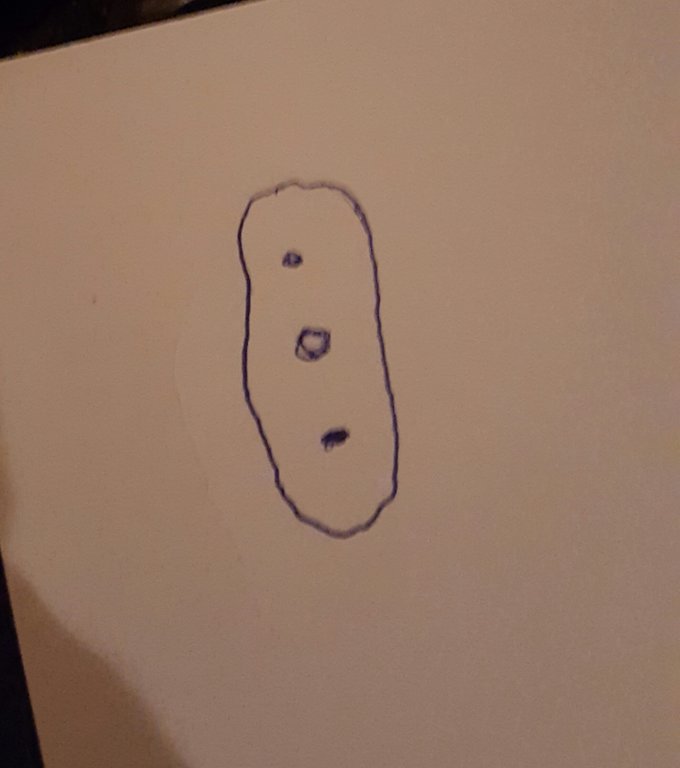

Another idea is to make a cardboard template for each side. (Please see incredibly artistic rendition)
I have no idea how the holes are located but you get my drift. That way you can measure up where the spoiler goes and then use the template to drill. Might be more accurate.

Thats a good idea too. I think there are 4 mounting holes.
I thought that maybe someone with a factory drilled trunk lid,
can make a template from tracing paper.

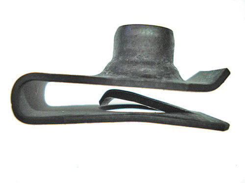

Just an FYI. Good idea to ditch the factory u-nuts that take basically a lag screw and replace them with threaded u-nuts and bolts. It's a piece of mind thing. I just didn't trust the little lag screw deal.
