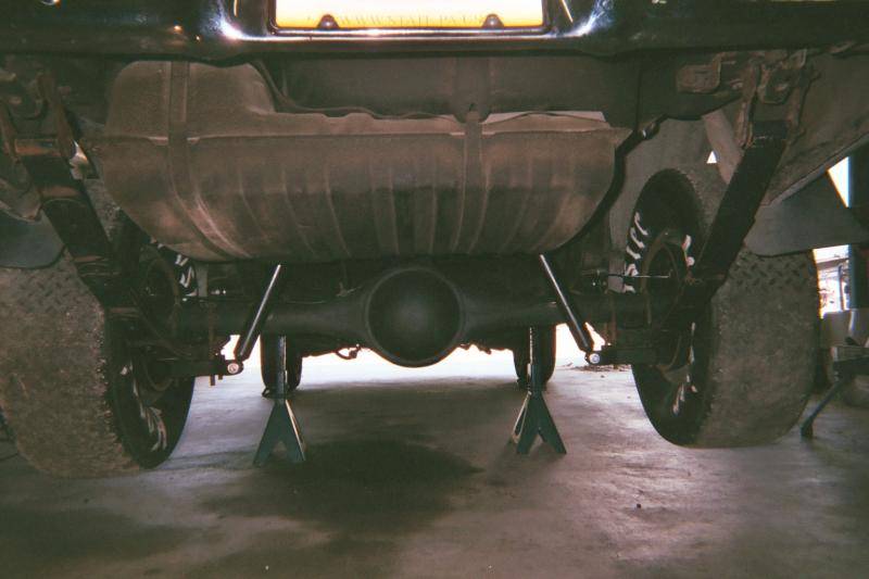

I will be changing my 8 1/4 for a 8 3/4. Found this Mopar Performance spring set up. Has anyone try this. Was it an easy swap? Thanks MP 3690456(L), MP 3690457(R) and MP4120081 Front Spring Hangers

Not to difficult. One bulkhead (each side) for front hanger clearance has to be removed.
