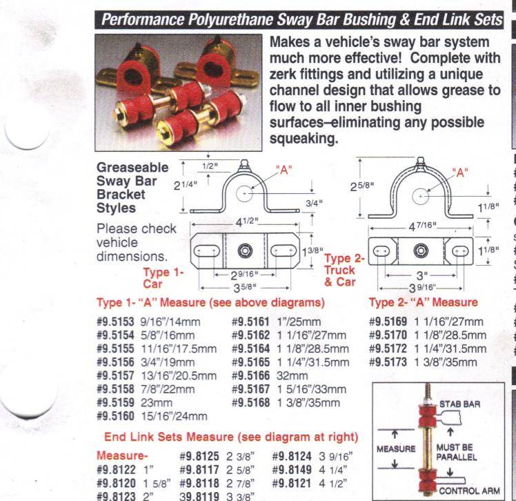

Where can I find some new bushings for the rear sway bar? I'm getting a rear bar for my 5th Avenue from a Diplomat, and would like to have new bushings to go along with it after I clean and paint it. Thanks.:help:
This is where I got mine from. Energy Suspension
fyi those aren't rear bushings the part number for rear bushings is 3402492
