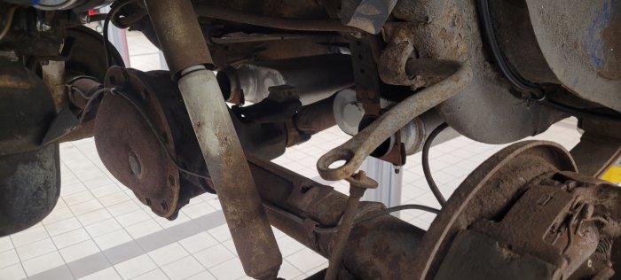

i cannot find a part number (or brand) aftermarket for the rear bushings and links. only front. i know OEM will be long gone.

these are my issues

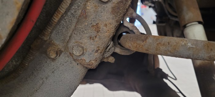

these are my issues

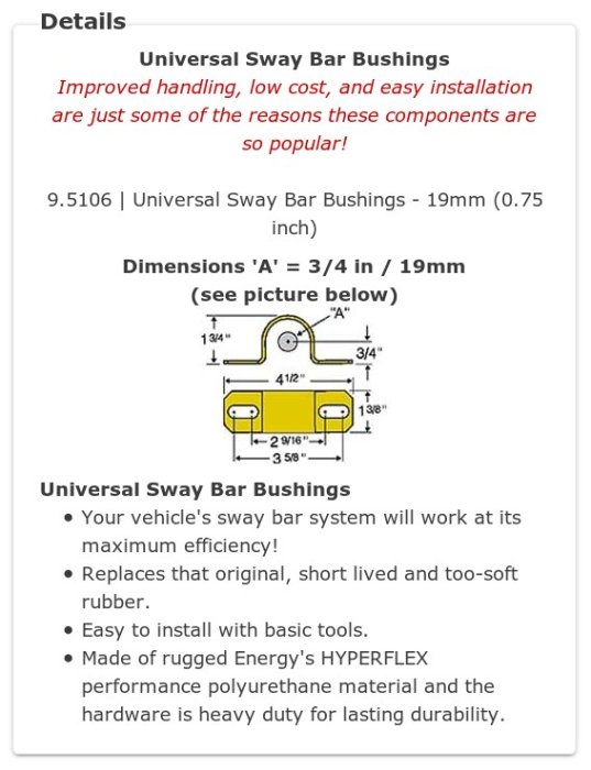

1) 9.5106G BUSHING, Sway bar bushing and bracket kit (3/4") (POLY), EnergySuspension
2) 9.5110G BUSHING, Sway bar bushing and bracket kit (1") (POLY), EnergySuspension

Look these up on SummitRacing, etc...but to start you off with I've attached the 9.5106 piece specs.

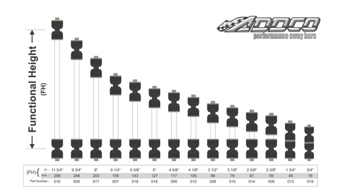

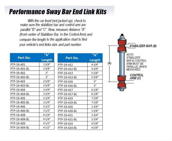

For the end-links, I've attached a Prothane chart, shows part numbers...measure what you need, if they do not have the exact one, find the closest next thing.
Next is the Addco equivalent...seems like these guys have some longer options!

Ahh, OK, so one more comment I would make: the ideal link<=>swaybar interface should be at a 90deg angle. For that to happen you really need to have the chassis fully loaded & suspension compressed so that you can get a real read-out of the end-link length to facilitate that 90 deg. setup.
If you can't do that, well, don't get hung up on it as a few degrees off won't cripple you! lol
If you're sticking with stock height of near it get one that matches the original.
