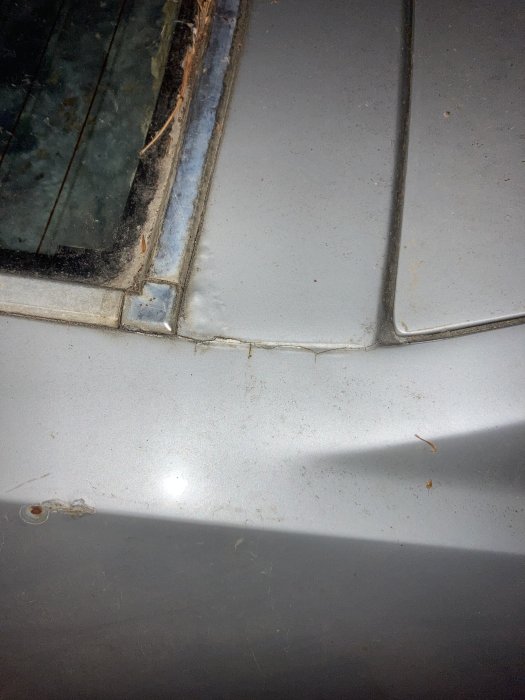

Yep, it is probably a rust pinhole.. as there is a rust bubble right at the bottom/corner of the windshield.
Also further evidence is the paint has cracked in a straight line between that corner rust bubble, straight back which I suspect is the seam between the rear quarter panel and what ever the narrow trip of metal that goes across to the other side of the car...
I will try to get a picture and see if I can upload it..

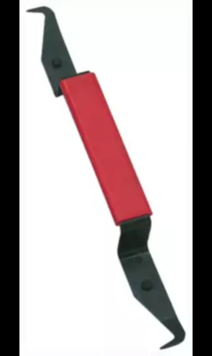

You'll need a trim remover tool
Take your time and use the tool to pop the trip off the clips. These tools are usually available at any auto parts store. And be careful, the pointy end can slip and it's sharp.

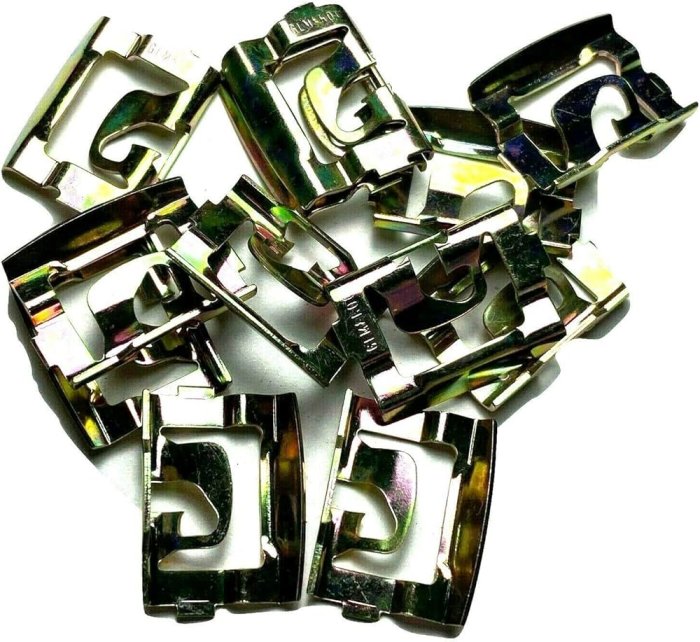

Someone here will need to check to see if I'm wrong about J bodies, but on M bodies that rear trim is held in by clips
The trim remover tool catches the clip and pops it off the back of the trim.

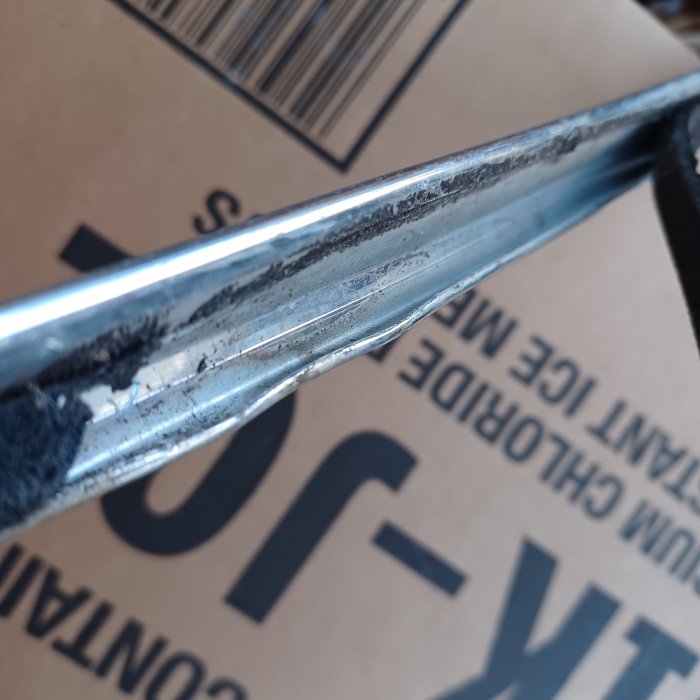

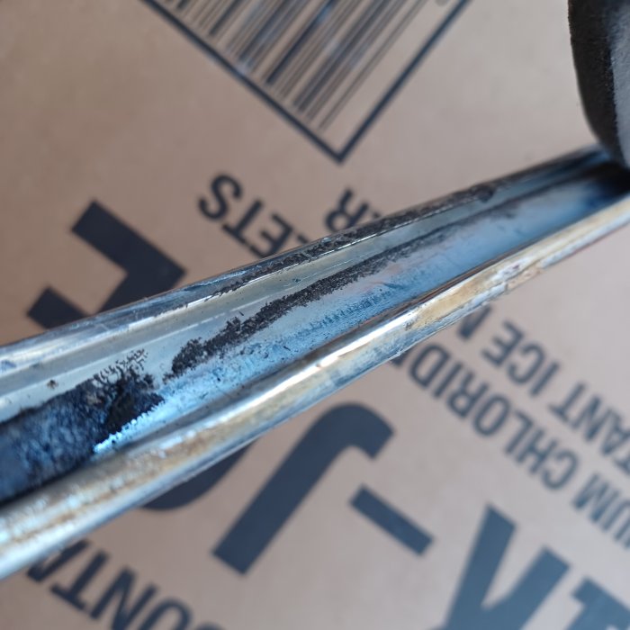

I have a spare piece of trim off a Volare, there's a channel on the back of it that the clip catches:
