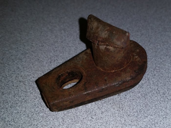

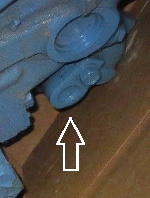

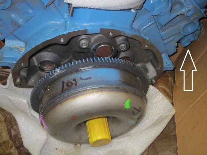

The /6 head was redesigned to allow for this system. A hole (a little less than 1” wide) is drilled almost length wise in the head. Then small holes are drilled into each exhaust port (about ¼“, each). The Aspirator (or A.I.R.) pipe bolts to rear of cylinder head. The same cylinder head was used for all /6 engines made, even for export (ie: with or without Aspirator or A.I.R. pump).
On the cases without, the OEM plate/plug bolted to that port - looks like this:
/6 is at rear of head at same level as manifolds (if equipped).
There is an alternatives one can use – which I’ll get to later.
To bypass that system OR to use a newer /6 in an older car (say a ’66 A-body), a person will need to block that port.

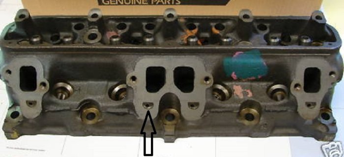

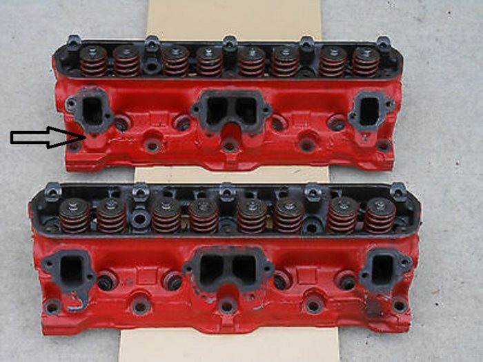

On small blocks. From (I think) ’74, until replaced by the Magnums, the system is different.
First the cylinder heads have a taller exhaust manifold flange. Below the exhaust port, there is a ¼“ hole drilled at an angle onto the exhaust port (on cylinder head).
The one bottom picture, I suspect the A.I.R. ports have been plugged and painted over.
On the exhaust manifold, there is a channel cast into it with ports on both ends. The front side of the manifolds have a pipe plug screwed into it (which I do not have its measurements with me at the moment).
The back side of both have a similar flange but no pipe plug. This one will have a bolt hole on top. Either the Aspirator tube or A.I.R. tube/pipe bolts to (like the plug picture, above).

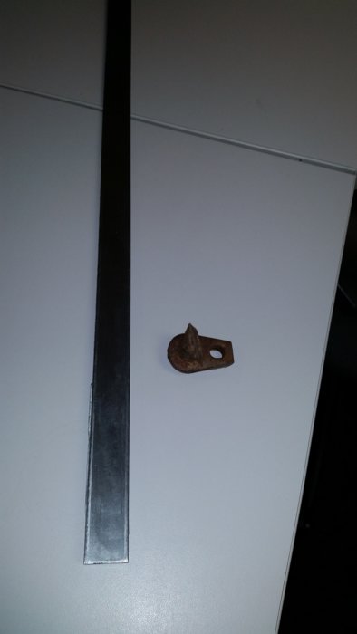

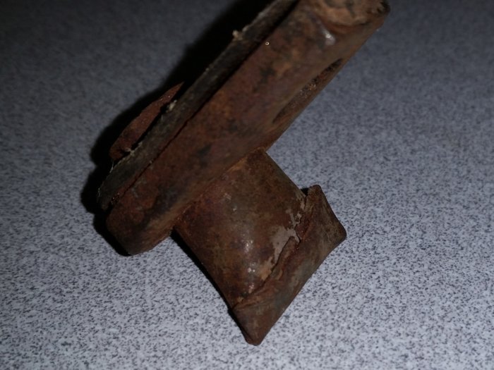

If your old Aspirator pipes are not “too rusty” and yon can make a cap, by cutting the tubing about 1-1/2” or so, out and then crimp off the end (a hammer or a vise does a nice job). I prefer to fold the crimp myself – but one has a few options. If not folded, then you will need to weld (or whatever) the seam - so there are no leaks.
Example:
Note: I didn't do this one. I would cut pipe a bit father out, for this short is "too short" to do things.
Note: If pipes are not rusted too badly, there are people looking for these in emission states - so think about others, before cutting!

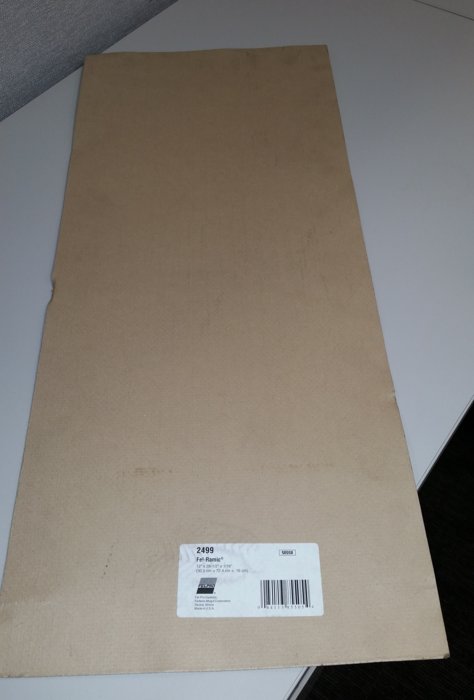

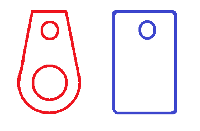

OR, find a OEM plug/plate (not easy to do), or make your own plate.
I have purchased some metal stock to make some plates as well as gasket material to make gaskets with – but hadn’t done so yet. Also, my garage is WAY TOO COLD to be out in it making some, until spring time.
The last picture is "make your own header gasket" material

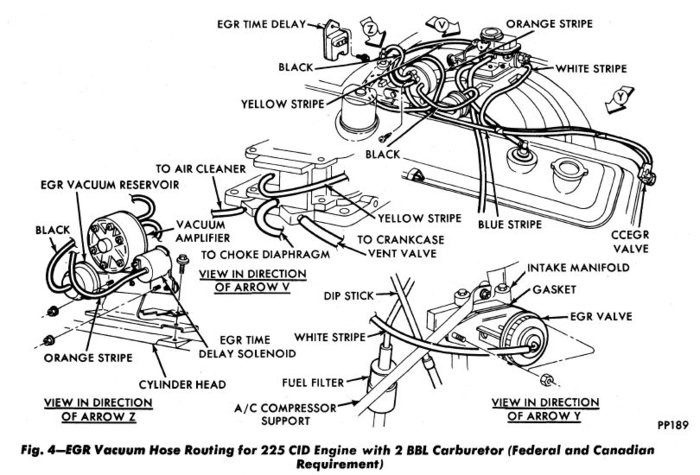

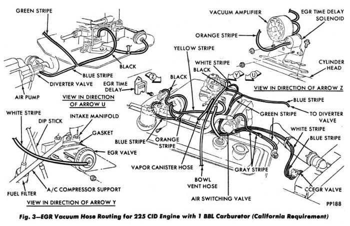

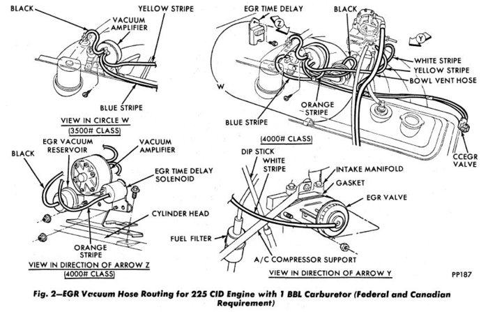

As far as trying to figure out what to remove emissions wise, what I recommend is to find a vacuum diagram on a “pre-EGR” car, like say from a ’70 or ’72 model car.
Then laying it out beside a copy from your car. It helps to take a LOT of scratch paper and slowly start to peel back the different layers of vacuum hoses and to what they connect to – to get back to what vacuum diagram you did find, shows.
Then remove the rest of the parts the hoses connected to.
I found these in my ’77 FSM (Factory Service Manual) not knowing what year vehicle you have. If you don’t have a FSM for your car, take a look at the decal on your car, take a picture of it, blow it up bigger and use it. If you don’t have a legible decal, make a new post asking someone else with same year and engine to take a picture of their vacuum hose decal.
When you get done, you should have:
A short hose coming from base of carburetor to choke pulloff (on side of carburetor).
A hose going from carburetor to distributer, for vacuum advance.
A large hose from carburetor to PCV valve.
A large hose from vacuum tree to brake booster (if you have power brakes).
A hose from vacuum tree going inside of car for AC/heater controls.
A hose from firewall going to your hot water valve (coming from A/C, if you have A/C, that is).
Two hoses (large and small) going between the carburetor and charcoal canister.
A large hose going between crankcase breather to air cleaner.
A hose going to air cleaner, for cold temperature/hot air flap control (which you might not need in South TX).
