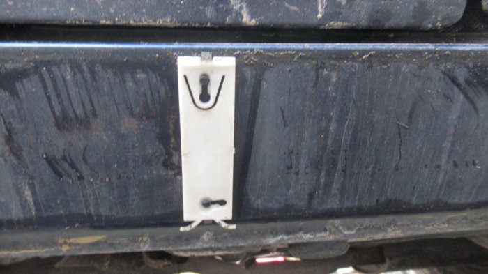

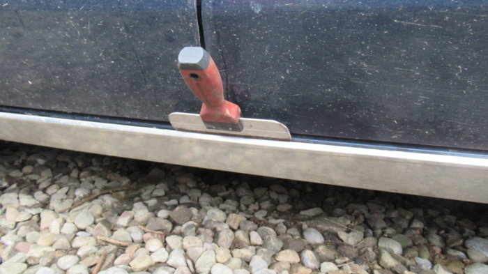

i found that if you push or lift Up on the bottoms and use a Big flat blade scraper/drywall scraper and very carefully Twist it,
that the trim literally pops off easily.
most of my tabs were good and i think? i only broke one myself.
the rest look to have been gone for some time/the little arms at bottom.
also,4 door lower trim does not fit 2 door lower trim....
dont ask me how i know this
;) lol

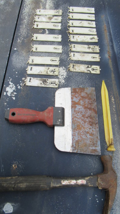

the flat scraper i show does a much better job of spreading the load and not damaging a thing.
i had both tools on hand,and chose the scraper Because of this.
speaking of tools,
in case any of you were wondering why the hammer and tent peg are in the pic lol.
once you get the trim off,
those clips have to come sideways at the bottoms,
and they seemed to be happy where they were.
a couple of taps with the hammer and stake and they popped loose,no marks no fuss.
