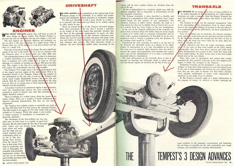

Best I can tell from my research..
1961 - 1963 Pontiac Tempest had the tophy 4 engine (half of a 389) and a 'rope drive'. Was only made 3 years.
There is a difference in length between manual (what I have) and automatic (only things I've found for sale).
When folks say they have pontiac/tempest parts, they usually mean they have 1964 and newer. They also usually assume you want a normal transmission/driveline/differential setup like in the early LeMans. That is not what I'm looking for.
We need to get you a day off to come down to Texas so I can show you the car and we can go to the boneyard!
Til then, here's a link to article in 'The Truth About Cars'...
Tempest Cross Section - The Truth About Cars

quote:
The two halves of the drivetrain/powertrain combination were joined with the ‘rope drive’. This was a one piece, flexible shaft of 87.25″ (2216mm) in length on automatic cars, 82.3″ (2090mm) on manuals. The diameter was 0.65″ (16.5mm) on automatics, 0.75″ (19.0mm) on manuals.
unquote
I was more concerned about the torque tube and drive line rather than the overall length of the car.
