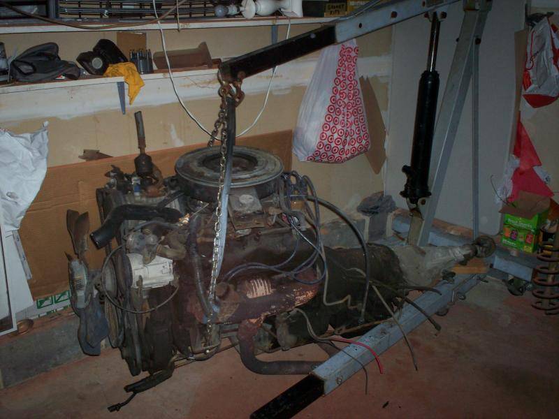

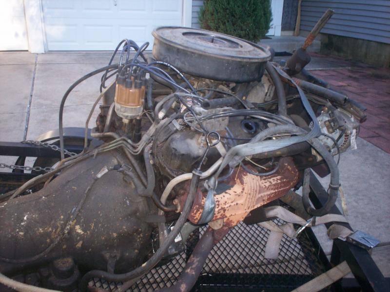

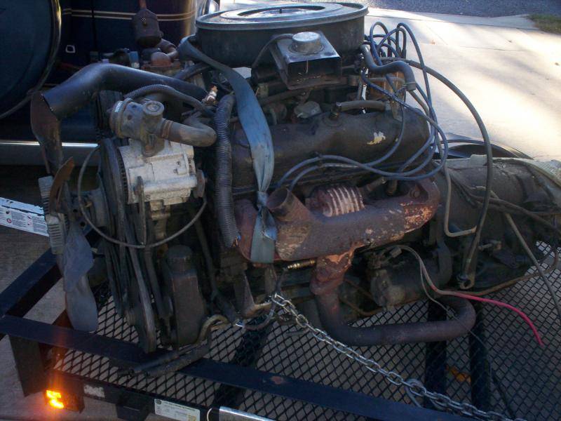

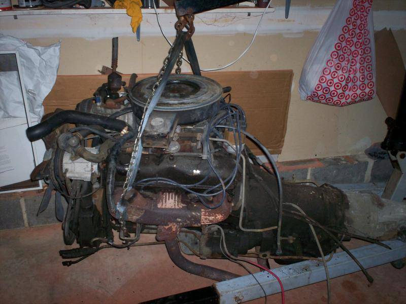

OK it's not from an FMJ, but what this is:
Swirl port head roller cam LA 360 out of a 1992 3/4 ton. The trans is a non lockup overdrive automatic non computer control type.
Everything is there to safely convert this to an Edelbrock thunder carb sitting and a Weiand Action Plus intake. I will need to change the pick up tube and truck pan to a car pan.
This has the Magnum style starter and alternator. I will be removing the AC bracket and it's smaller newer style compressor- any takers on that?
The guy would not take less than 500 bucks, so I am able to live with that. Can't buy a running motor for 500, let alone an OD trans.
