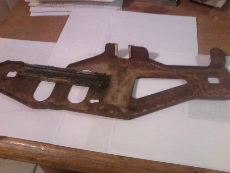

I just acquired my latest drug an 81 Mirada and of course it needs many things. Starting off with my side windows, the bracket bolted to the glass slides up and down on a vertical shaft and the top bushings that provided the smooth and quite operation are worn and what ever was on the bottom are missing altogether
This is the passenger side bracket
Haven't tried the local Chrysler dealership yet. any help with the name of these parts or finding replacement parts will be appreciated

google a product called moleskin. manmade anti friction hd fabric used for many things. It is a very good match to the product used on those "guides". You can contact cement it over the worn "guides" if they're not to deteriorated.
