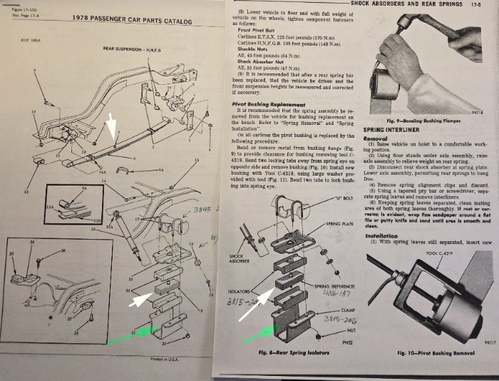

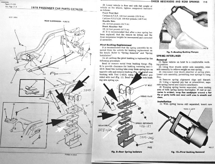

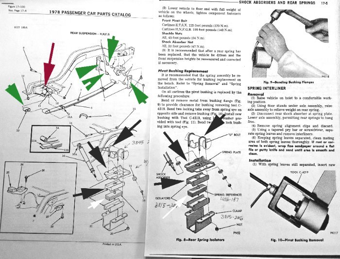

I have just started to go thru the instructions regarding the springs and change the rear axel on my G22. Gosh, I feel like an idiot sometimes as it must be 50 years ago I was under a car with springs like this. I had a BMC 1800 and a Ford Transit at that time, all gone years ago!
Now things have cleared a bit and narrowed my search dealing with a swap. The first picture with white arrows are what I had overseen. It is the spring going thru the bottom and upper spring plate. A bolt secure the springs to the bottom and upper spring plate. Bolts represent minor problems as those are often off the shelves from autoshops and EBay.
I dropped a clanger having overseen that fact.
From that picture I have made another one with different colours on new arrows pointing to the bottom clamp. It is a little unclear to me if that one has to be replaced by another one as on picture three. To me it looks like it is the one as the holes seems to be correct and the centre pieces to replace the bottom Isolator. Is that correct? I presume there must be a replacement to the top Isolator too?

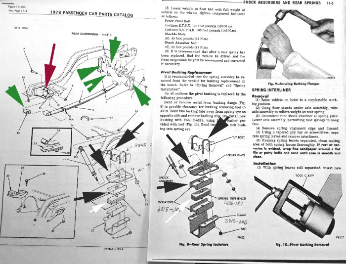

Now to the tricky bit: The top spring plate:
From the parts catalogue I note the 8 1/4" axel has a different part number than the 7 1/4". I have a feeling the bolt holes must be 1" wider spaced on the 8 14". That might affect the angel of the shock absorber? Probably only 1/2" but as they are rubber bushed. Anyway The upper Isolator may be the problem or can this one be omitted? Picture 4 shows the problem and parts needed to be replaced.

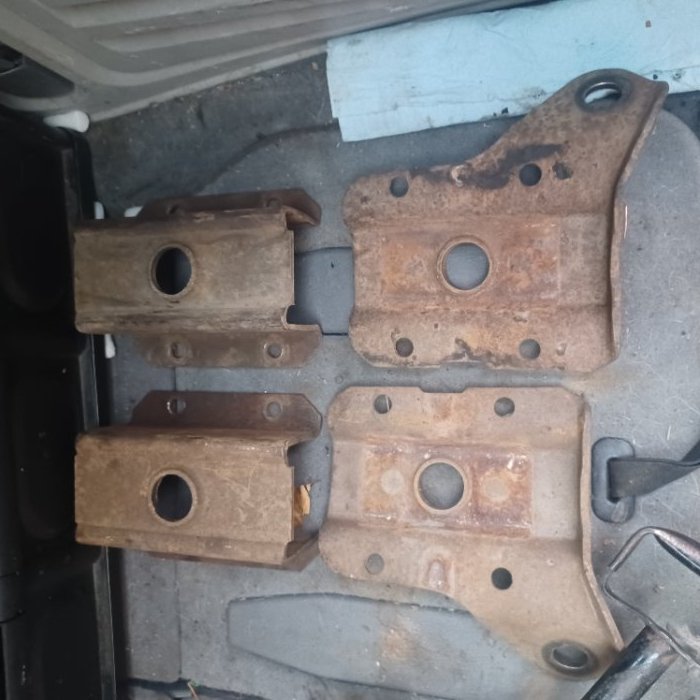

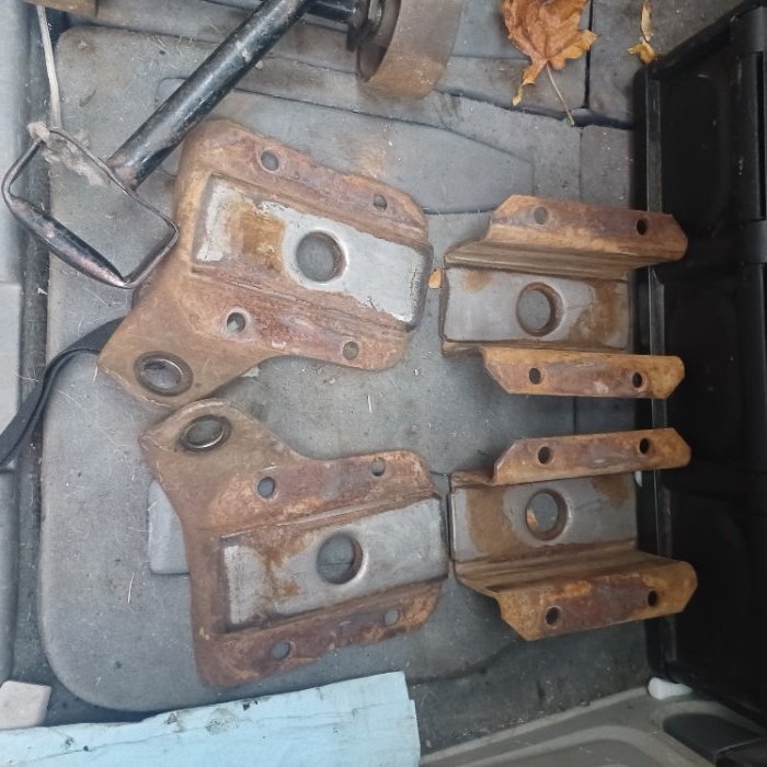

Picture 5 I am not sure what this part is needed for. The centre holes indicates (as well as the shape) it could be used on top of the top plate as it may fill out the gap of the upper Isolator? The Ubolts should be wide enough to pass on the outside of them.
Picture 5 shows a new Schock plate but may be it fools me as it has another axel probably needed for either the schock absorber or the swaybar? I doubt it is for the swaybar and not needed as my car has no rear swaybar. Perhaps the schock absorber would fit anyway? On the inside near the centre of the car?
I have got hold of all other parts pointing as marked with green arrows and the red arrow points to the Leaf Spring hangers. I have not checked those but they seems to be my cup of tea as they are in front of the springs.
Hoping things may be sorted out for me as the winter has setteled with snow, icy roads and frost. We do live in a country with that sort of weather but telling drivers to take things easy and use proper winter tyres seems to be throwing water on a Goose! We never learn to we but please omitt me: I am too old in the tooth to be surpriced by the winter!
Thanking you in advance for any help and advice.
Regards Gunnar
Regards Gunnar

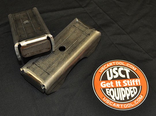

I'm trying to figure out what all you're referring to..
The part with the USCT sticker is the bracket that's welded to the axle that sits on top of everything. Your axle should already have it.

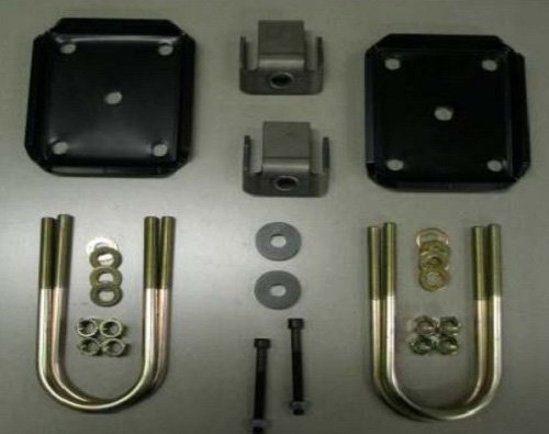

These parts are all you need. One goes above the springs, the other goes below. With this setup you dont need the isolators. Those 2 small silver square thins look like what you weld on if you have a rear sway bar.
Yes there is is a different top plate because 8 1/4 on those early cars has bigger axle tubes but if you are buying the brackets in these pictures it eliminates those stock parts.
The shock is supposed to go to the part that sticks out, which I'm not quite sure how it would work since our shocks are angled in. I think on mine the stock top plate was kept and only the bottom plate was replaced. This was done years before I bought that car.
The parts with the black arrow aren't needed if you are replacing them with those new spring brackets.

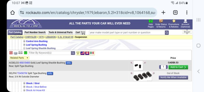

The green arrow parts are pretty easily obtainable. The spring shackle could be a bit harder but if yours is reusable the bushings are on Rock Auto. The bushings for the end of the springs aren't that hard to get.

Thanks Mike for your advice and things have cleared a bit now. I have contacted the company and a reply came prompt. I have asked them to pick what I need for the job as the only thing I am a bit worried about is the angle of the shock absorber. I have a feeling these has to be replaced with a new pair with eylets. Here is their reply:

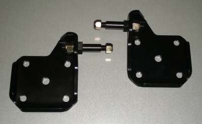

Hello Gunnar,
Our Iso delete kit will eliminate the iso wraps of course, moreover the shocks will then be B-body application - not the bayonet style, but the eyelets on both upper and lower mounts (using our B body shock plates - the set illustrated in the picture). We also have an iso delete kit which will use your factory shock plates so you can keep your correct bayonet style shocks (and the stock rear sway bar if you have one), as well as eliminate the iso wraps - either kit cost $425.
We ship inside the US right now. Also, we are probably around 5 weeks lead time for that kit. We are slammed here this winter already.
We appreciate your interest. If you would like the kit with the B body shock plates - $425 plus shipping - we use the most economic shipping within the states and make money on our manufacturing and assemblies; we do not make money on shipping here. Shipping and handling is calculated after we make the parts and package them up to ship that day.

So @Gunnar Schroder, are you clear on what FirmFeel is suggesting to you?
Like @Mikes5thAve explained, the aftermarket options typically require you to remove the ISO setup and replace that with a B-body style configuration.
The 'ISO-Delete Kit' has the TOP plate (the square with 5 holes) which can have the sway-bar brackets welded on. That setup would give you an equivalent functionality of the factory configuration, but requires you to switch to B-boy style shocks.
The alternative is to buy just the bottom plate (FF's 'Shock Plates' part) and simply bolt those to the bottom of the leaf spring WHILE discarding the U-shaped ISO bracket where the rubber pads capture the leaf-spring pack. This will result in what @Mikes5thAve shows in his photo, and allows you to retain the factory shocks.
The choice, for the most part, depends on what you are looking to do. There are very few performance options for the factory configuration, while the B-body domain opens things up considerably.
Thanks for your mail and one thing puzzels me: The upper spring plate where the shocks are fastened may need to be modified to accept the U-bolts as the axel is 1" wider. As from the spares list I have they have different numbers. 7 1/4" axel plate has number 3845 168-9 and the 8 1/4" has 3845 128-9
Of course I can weld and close the old holes and make new ones but had hoped to avoid that. No need to worry about a rear swaybar as my car has not one of those.
I think the 7 1/4 plate is too small to Redrill with wider hole spacing. For the cost of those from firm feel you could probably find someone local to make them up. Really they're squares if metal with the edges bent up to make them more rigid.
Good morning Mike and thanks for your mail. I feel the same as you about redrill wider hole spacing. To have two made locally could be a good idea but over here there are no craftsmen or workshop dealing with that. The skilled labour force are gone donkeys years ago due to computers and workforce afraid of getting dirty hands. A shame really
