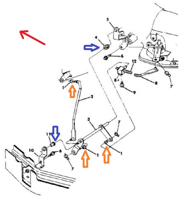

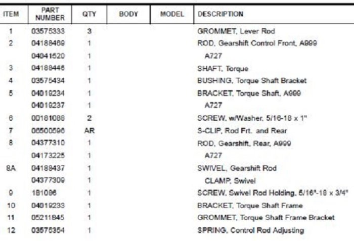

There are 3 different bushings used on ‘87’s, so I made a printout for you to make sure which one you are needing:
Item # 4 and 11 (blue arrows) are the Z-bar pivots (one of each).
Item # 1 (orange arrows) are the rod pop-in retainers. These can get rather brittle and reuse of them is iffy. Dodge says to replace every time the rod is popped out. Back when cars were relativity new, I could reuse them without issues. Now days, most of them crumble when trying to disengage the rod from bushing.
Grommet 3575333 (Item #1) MSRP (Manufactures Suggested Retail Price) $5.85 (US) each
Bushing 3575434 (Item # 4) MSRP (US) $2.45 – but is discontinued but some dealers might have one in stock (maybe).
Grommet 5211845 (Item # 11) MSRP (US) $7.10
Hopefully this helps.
