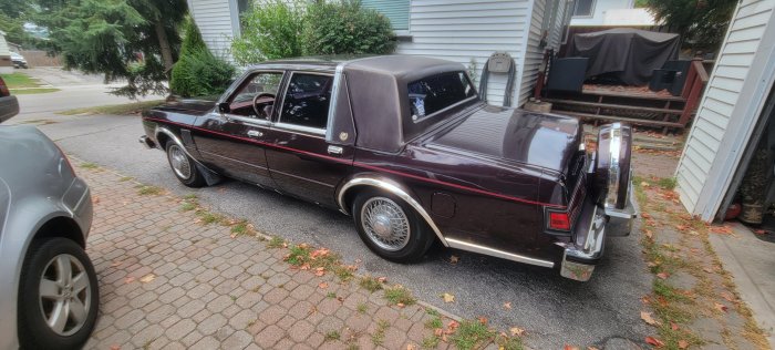

The fronts just unbolt and you push them down to get them in and out. The backs are bolted to a rail under the car and to the leaf spring plates. There is no access behind the seat or in the trunk. Get ready to use a wrench in a semi-tight space.
It looks like you have a lot of sag in that rear end and you might need more than shocks to help you out

It has a little sag.. as can be expected. And yes, i know shocks arent what set ride height. Lol. It is needing shocks because the entire car floats uncontrollably over rolling bumps.
Granted, i had the trunk and back seat loaded with camping gear, and there is a subwoofer that resides permanently.
