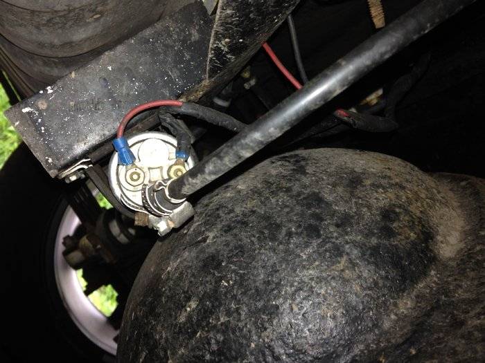

thanks brother. Now where did you mount your electric fuel pump on your Mirada after you went back to a stock style tank? I'm headed in that direction
I used an inline EFI pump on my car. I mounted it to the front facing side of the tank straps. On mine, because I no longer had the plastic shield that came stock, I made a mounting bracket that locates the pump between the two straps, and right at the bottom of the tank.
My son had some issues with vapor lock, so I also installed an inline pump for him. His had the tank shield in place, so I mounted the pump right to the shield, in basically the same place as mine.

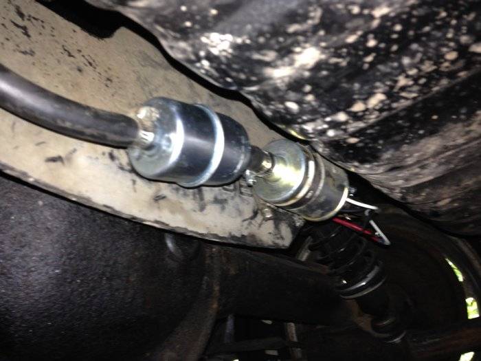

got a picture of either?

This is little Joe's pump. The photography sucks, because the driveway is still wet and I don't get down that low anymore. I'll get more on the lift if you want.
