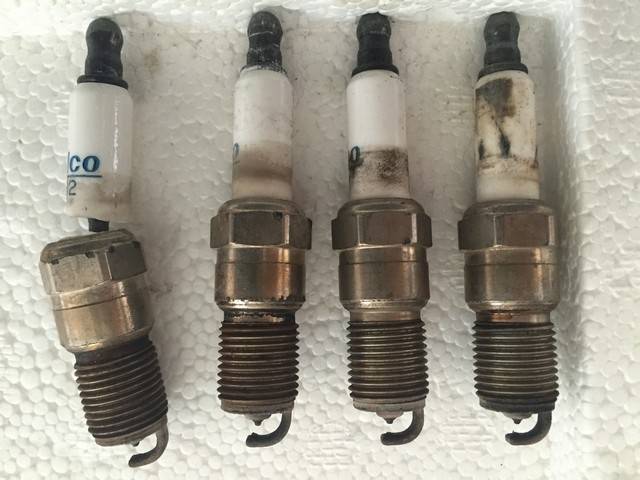

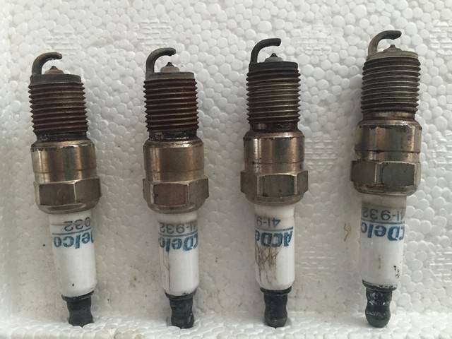

Here's what my old spark plugs looked like.
Tried to get them so you could see each bank.
I did break one getting it out.
There is so little center electrode that I'm amazed the truck would run.
After the change, runs like a champ.

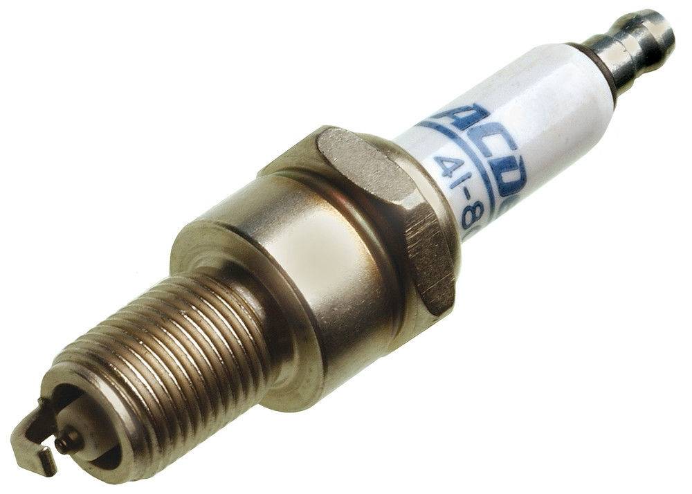

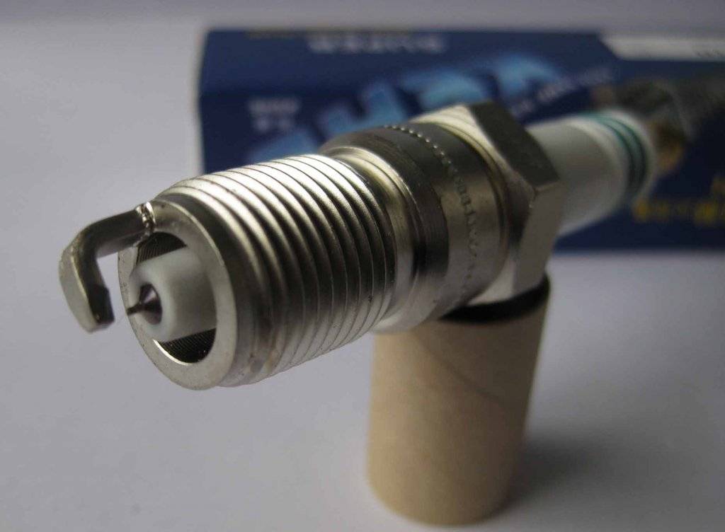

Those are platinum tip plugs and the center electrode is supposed to look like that although, those are worn some. You should see the iridium plugs some vehicles take. The center electrode is about the size of a sewing pin.
I can spot what was most likely the main problem and that's the carbon arcing on the insulators (the black lines). That's most often caused by bad plug wires that "leak" and the electricity bypasses the plug and travels down the insulator to ground on the plug body. Always remember, electricity is like some people, it always takes the path of least resistance:D
Platinum plug:
Iridium plug:
