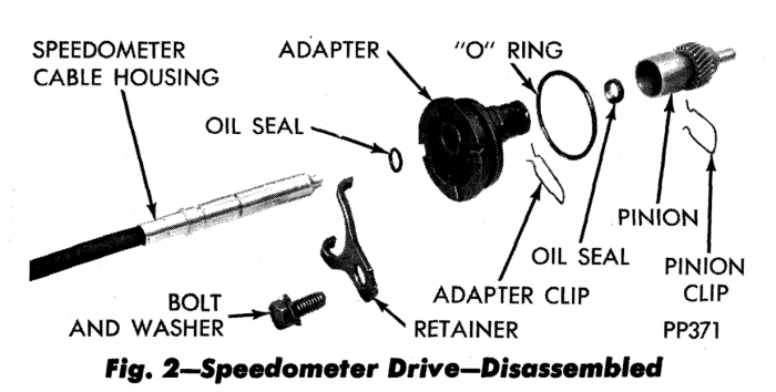

Just got done working with a friend on a 7 1/4 —> 8 1/4 police 2.94 posi swap on the 85 Diplomat. Car has the original 318 with 904/999 transmission.
I am trying to locate the correct all-plastic 29 tooth speedometer gear. It has been elusive.
Does anyone have a Chrysler part number or a good source for this item?
Thanks in advance.

I spoke with Dan at Brewers this AM. He was not hopeful that gear would be in stock anytime soon.
I am hoping to find the original Chrysler part number to see if I can locate one.

The Chrysler part number for the speedometer pinion gear with 29 teeth (black) for 1985, and others, is 4058129.

Talked to Leon at Silke’s—
Got the gear ordered using the part number provided. This is super helpful and is going to save me from having to swap the speedometer cable/housing.
Much thanks to everyone that responded!!!
