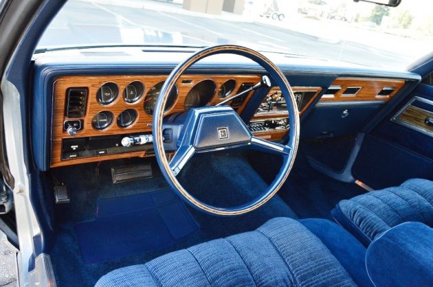

doba or mirada for a 120 mph
The first place I would look would be a police R-body; certified up to 125 mph. These were produced for three years: 1979-1981. The models were Chrysler Newport, Dodge St. Regis and Plymouth Gran Fury. Here is an '81 Newport (non-police):
