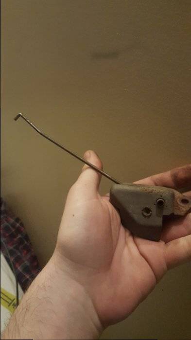

This is the old thermostat i was working with. Previous owner had it on, i do not know the history under his ownership very well unfortunately.

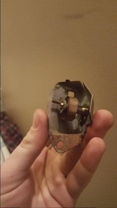

I know its a bad pic, but thats what i am working with. When i took the thermostat arm off, the choke moved like it should, with the old one on it was stiff when hot and stiff when cold and didnt move as it should. Idk
