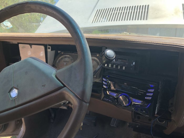

ok - I had to buy a new radio unit for The Pearl.. the factory radio went out in 2007 or so, and as such was replaced by a cheap Walmart special of that time. It was too small and just “sat” in the gaping maw that was the radio slot.
NOW I bought a bigger and newer one - that actually works - and was about to slide it in after connecting all of the stuffs - lol and behold, the thing is roughly an inch too big for the dash cover - although it should fit in the housing.
If not - what modification could I make to preserve my paneling on the front - and still have the radio mounted and done?

I removed the bezel panel with no issues, however the plastic slot for the radio itself was too small, and there was a metal bar running through the area that had curved edges that stuck up just enough to block the unit. I carefully bent it to slide it in, however it STILL just out way too far.
A cursory try of the paneling did not go well, so I’m kinda stuck. I am probably going to have to cut or trim the panel a little to squeeze it around the unit.

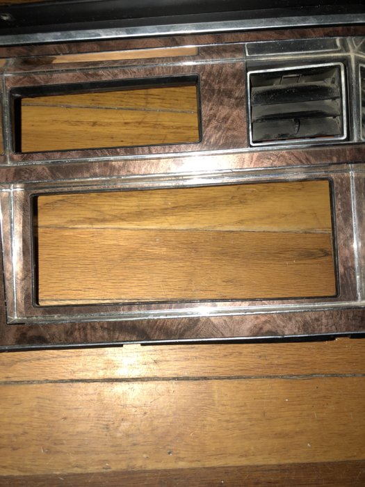

This is the bezel :
1,830
1,035
Don't butcher it, trust me. Take the radio back and get a single din sized deck.

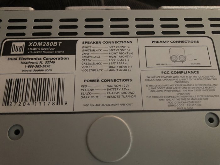

Ok - single DIN with the same exact connections that made the previous 2 DIN thing work - NOW this thing acts like it has no power going to it. I believe the extra wire coming out of the back of this is the ground wire, however the prior radio had none..
If the unit has zero power even though nothing has changed with the wiring, am I needing to ground it? Or did I, in my infinite wisdom, exchange a working, yet too big 2 DIN, for a dud of a 1 DIN
