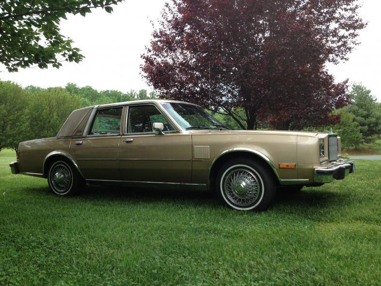

I agree holding off on the swap right now. I'll bet what I'm probably dealing with could just be a vacuum leak somewhere. I'm in college, so I just need something that works right now. I'll be throwing upgrades at it once funds are not so tight.
Here's some pictures. It's all original, and I just rolled over 60,000 miles. I put on the chrome caps about a week ago.

Well be still my heart -- that is magical!
I long to have my seam lines as straight and true as yours.
I like the color and it doesn't have the clear coat wasting off of it making it look nasty.
And, of course, your bumper filler upfront is not wavy. Sigh.
You be real careful or I might sneak to campus and relieve you of that filler....
Which would be one real good trick since I don't know your name, your city, your school, or where you park. I'm going to try the 3m double stick tape on mine.
