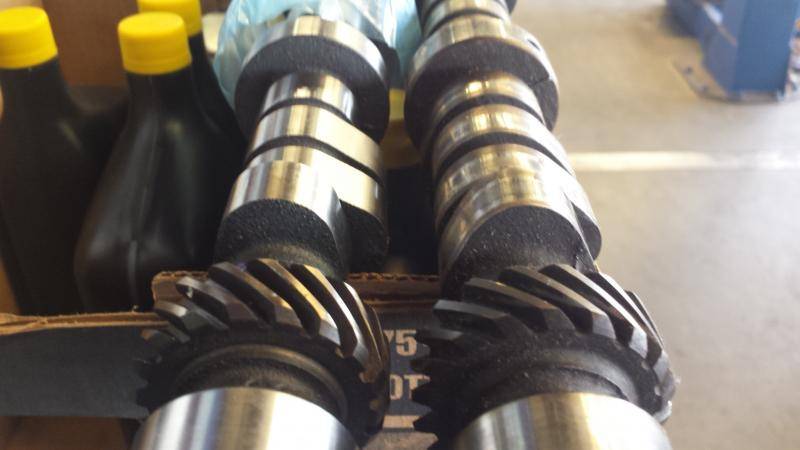

stock roller to performance roller cam compairison.
76volareman
Oct 12, 2013
62
3
Northern California
I thought this was kind of cool. This is a stock 1990 5.9l efi

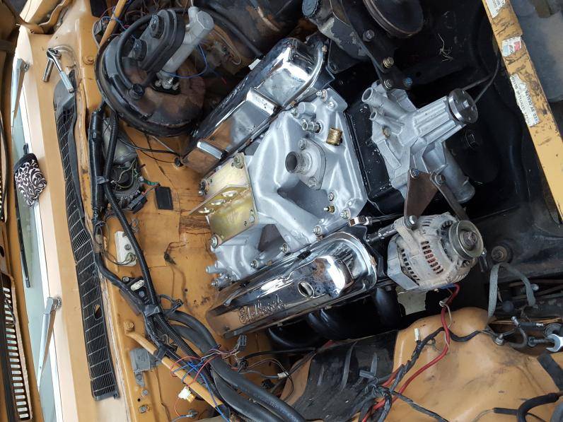

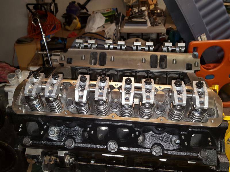

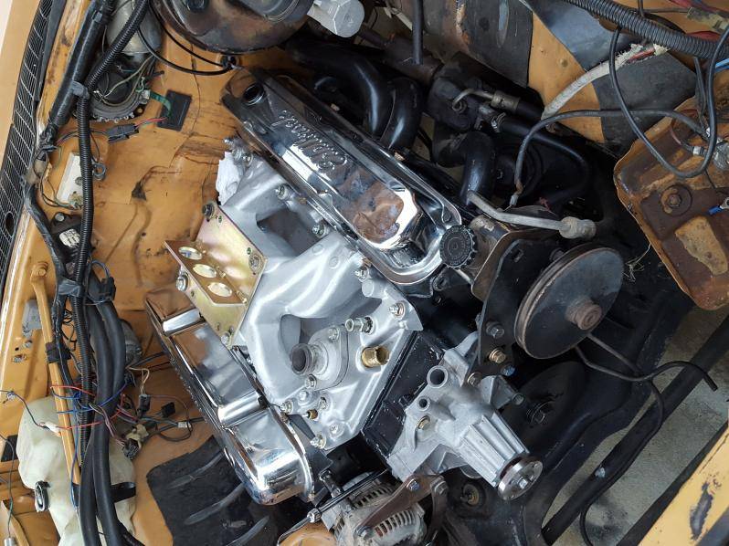

Roller cam compaired to a lunati VooDoo roller with 231-239 duration and like .555 , .575 lift @1.6 rocker ratio. Going into my new build, 408 with indy heads. For my 76' volare.
nice looking build, those 408's are a sweet combination

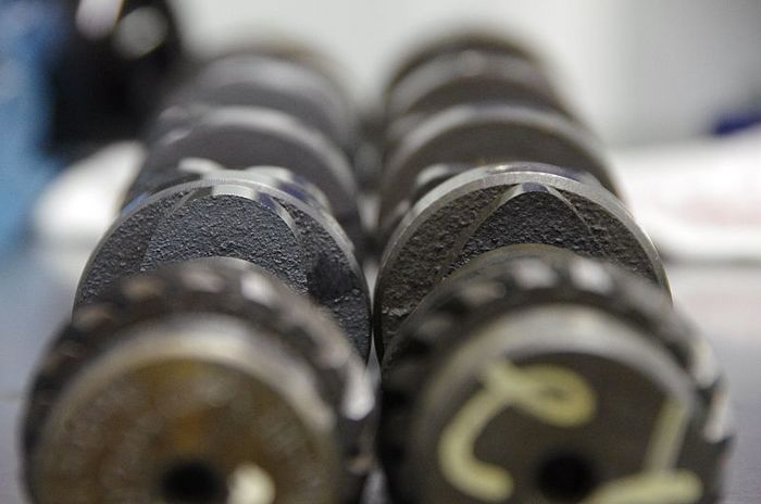

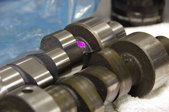

Here is another comparison, this time a fairly decent hydraulic flat tappet cam to a hydraulic roller that's maybe 2 steps bigger, so about 10 deg @ 0.050"
