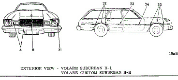

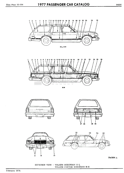

Need a bit more information.
I suspect a Chevrolet (or GMC), but it might be a Plymouth.
