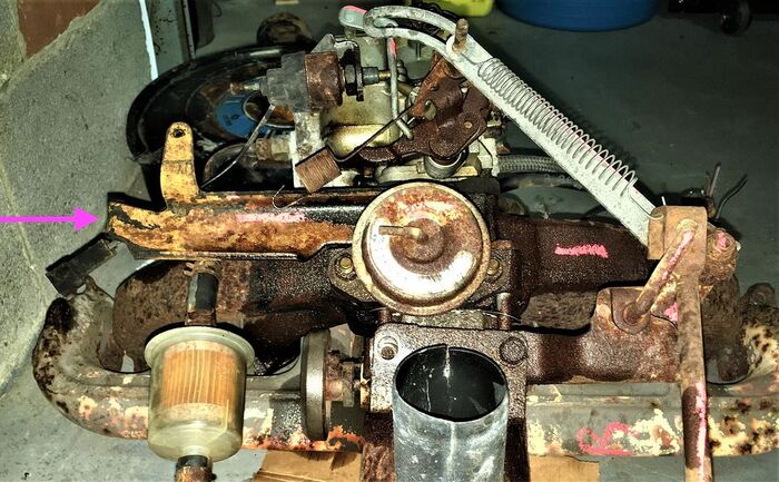

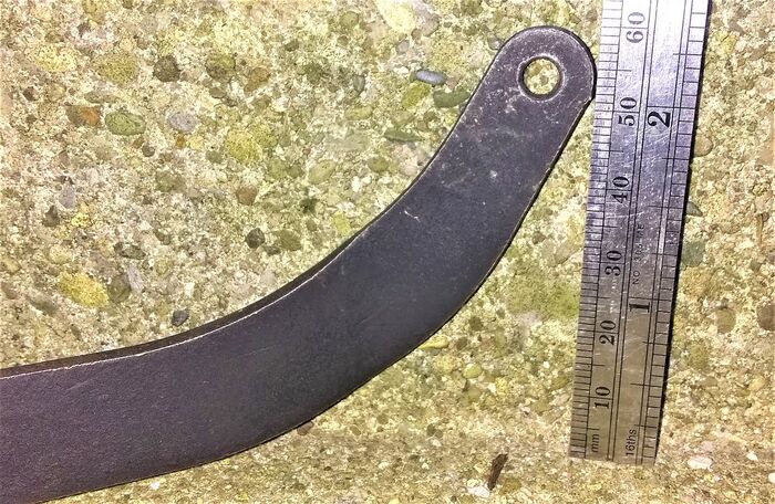

Anyone have a picture of the kick down linkage for a Super Six, going to add one to my "76"Aspen. Could use measurement on the bracket that holds the throtle return spring.
more https://photobucket.com/u/matv91/a/66147962-b13b-4f45-8880-e7feb7a1cf35/p/94c1b946-2bb8-452d-a27e-d64ae0c06649]
[/URL]

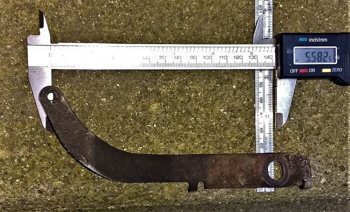

About 5 and 1/2 inches center of hole to center of hole not crictical ac used different bracket same but longer for ac compresser mount
https://photobucket.com/u/matv91/a/66147962-b13b-4f45-8880-e7feb7a1cf35/p/d987ef7c-0a92-4096-adc9-ab67434b2f6e]
[/URL]
https://photobucket.com/u/matv91/a/66147962-b13b-4f45-8880-e7feb7a1cf35/p/b8c16f90-d6c6-4076-babb-6fe14d27773b]
[/URL]

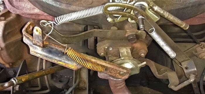

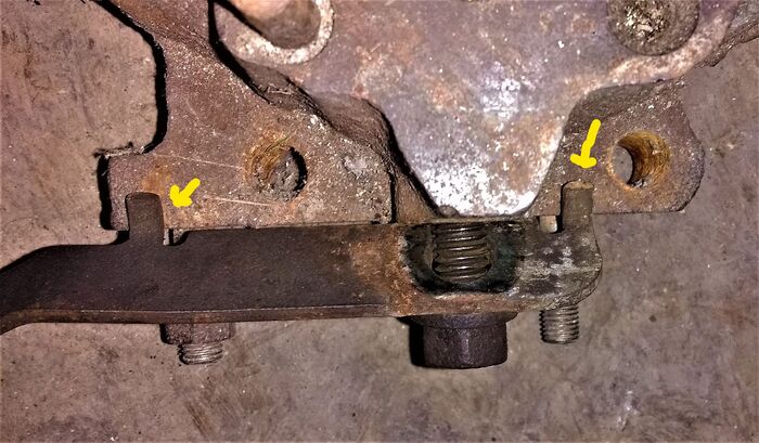

anti rotation tabs https://photobucket.com/u/matv91/a/66147962-b13b-4f45-8880-e7feb7a1cf35/p/c62f5220-3d74-4f8a-8cdb-fe445fcac689]
[/URL]

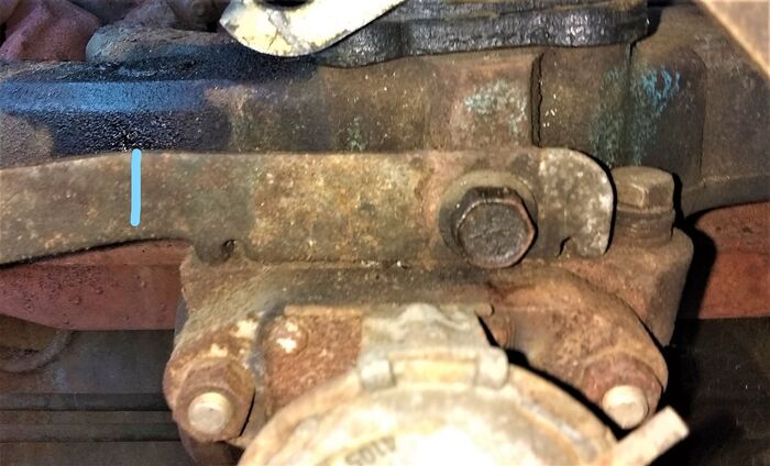

First bend https://photobucket.com/u/matv91/a/66147962-b13b-4f45-8880-e7feb7a1cf35/p/8790398c-72e3-4c22-a744-1674e3a7002f]
[/URL]
second bend https://photobucket.com/u/matv91/a/66147962-b13b-4f45-8880-e7feb7a1cf35/p/d8521770-73cf-4e47-bef1-12111c05d5e4]
[/URL]

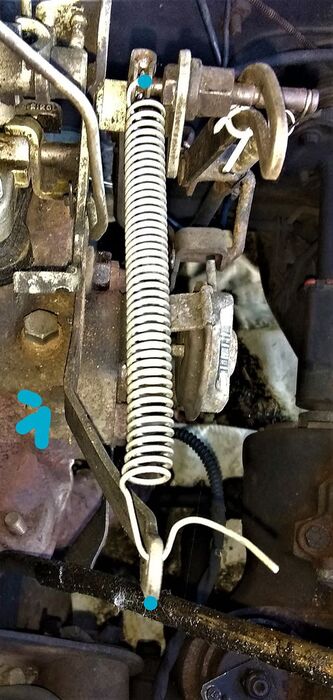

The bends are to line up return spring hole, height and alignment with carb https://photobucket.com/u/matv91/a/66147962-b13b-4f45-8880-e7feb7a1cf35/p/61d3af1e-ca1c-4aa0-bf21-f408c8ba7725]

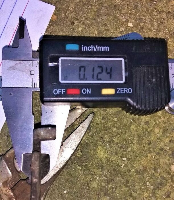

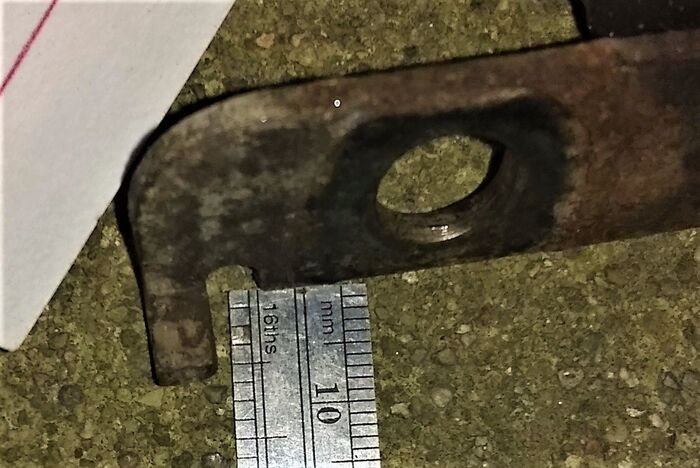

material thickness https://photobucket.com/u/matv91/a/66147962-b13b-4f45-8880-e7feb7a1cf35/p/7f3347a9-085b-4a99-a8bc-3912d9196783]
[/URL]
