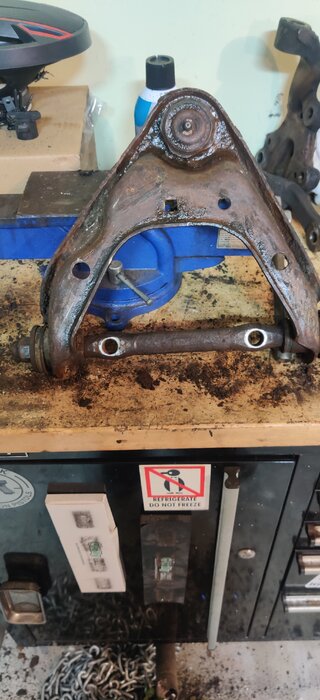

The nuts for the pivot bolt, I've tried every thing I have. Heat, plus a 4ft Parker bar in a vise and it didn't move. Asking with the ball joint. I ended up rounding the end of the ball joint actually.

You should be able to get them off. Good penetrating oil like, deep creep or kroil, let it sit for a day, spray it again and hit it with an impact or cheater bar.

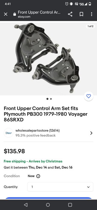

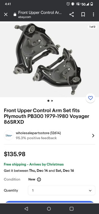

I myself wouldn't mind going with the upgrade but my dad is wanting to try and stick with stock as much as possible. We did find these online but they say voyager. They look REALLY similar but that is just an online pic. Has anyone tried these?

I wouldn't trust those, I would see if you can't find an image with them as they are, that say they are from a Aspen or volare, or an M body. There's definitely not reproduction ones out there unless they are the ones mentioned up above.

Don't ours need ones with the big gap to fit the shock through? Doesn't look like those will fit.
If anything Durango ones look more like theyd work but you'd need to compare whatever you try because any minor difference can throw the geometry off.

For the balljoints you need a special nut. Then penetrating oil and an impact. I did them on my charger (53 years of crust) and my '79 MB400 (thats the same as for the pb300 Voyager, and yes they don't fit).

Those voyager control arms won’t work. You’re right, they used the same control arms on multiple cars…Volare, Aspen, Miranda’s, Cordoba, Gran Fury, Diplomat, Fifth Avenues, Caravelle, lebaron…there’s a number of parts that are only available from other part cars. Stock control arms are one of those parts. Don’t bother throwing van parts at it, take your time, you’ll find the right stuff.

Take a wire wheel to the exposed threads and then soak with a good penetrating oil, soaking couple times a day for a day or two. Clamp the shaft in the vise and use the strongest impact wrench you can find. My old composite Ingersoll 1/2 was perfect for the job when I did mine.
