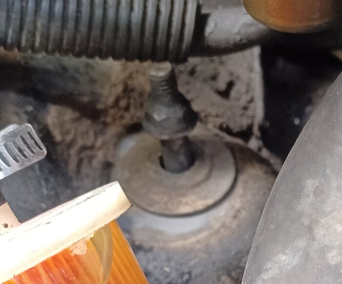

I've been road testing the car to shake out any problems and, crap, did I find one. It sounded like the wheel was falling off all of a sudden. Turns out the bushings on the sway bar retainer link on the passenger side decided to exit.
I'm wondering if anyone knows where I can get new ones. The threads look pretty smashed/seized. I've tried poking around but I'm not having any luck. My other thought was to try and get it apart and try and freshen up the threads with a die, maybe enough to try and thread a different nut on there.

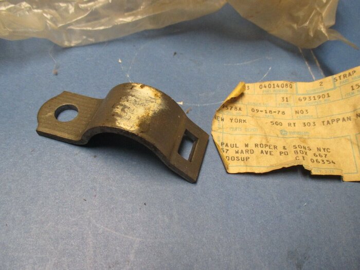

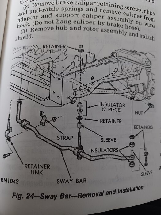

The brackets pop up from time to time but are rare. The replacement bushings are like the sway bar end link ones.
7,323
2,971
Like he said. The rubber parts are easy to get at the parts store or equivelant, the link/bracket (or whatever it's called) are not available aftermarket or repop, unfortunately.

Use heat. They usually arent too hard to get the nut off. I've has ones that look a lot worse then that.

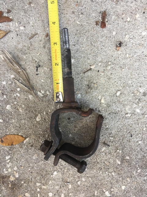

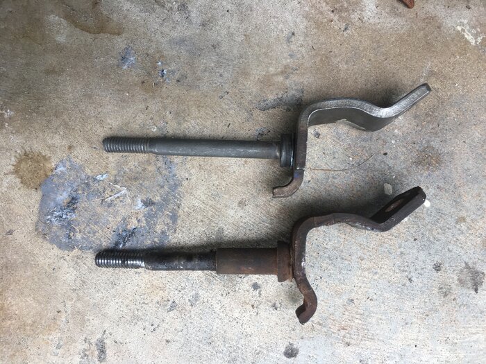

They are tough to find! I bent one on my AHB and had it repaired with good welds. And if your wondering, the AHB and Civi models are different but I believe you could use the AHB one if you're lucky enough to find one. See my pic of them side by side and you'll see the AHB ones are thicker from factory.

Yeah I'm worried I'll wipe the threads or I'll get it apart and find it's horribly bent. If I can get it apart and run a die down it, even if shrinks it maybe I can cross thread a nut on there it'll be an improvement
I'm saying leave the threads alone, don't loosen or tighten; take a large enough rubber bushing and slit it. Then open it enough to push over the link.

If you do try getting the nut off, run a thread chaser down the exposed threads to clean them up first. A lot of times the threads covered by the nut are fine, and only the exposed threads are rusted.

I got what you were saying, in the pic it looks like you wiped the threads, which is what I'm afraid of
They were like that when I started removing. I heated, bent back in shape, added reinforcement welds and it went back on fine. It was that middle section that was kind of damaged by fleet mechanic :(

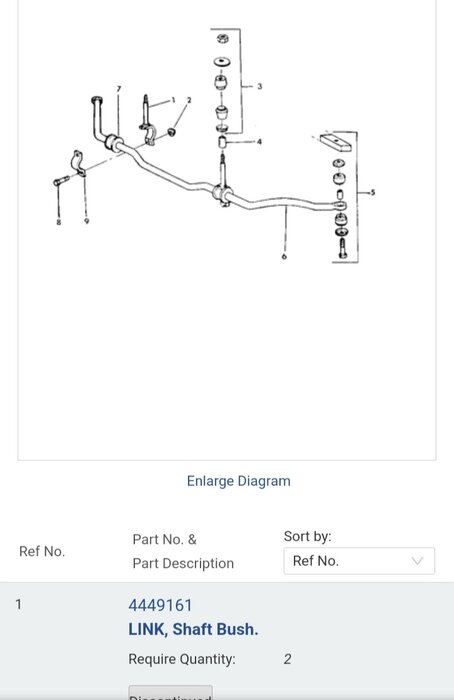

Thanks to Volare77, I got the AHB part number, found 2 sets, and paid through the nose on ePay for nos ones. Ended up being almost $160 with tax and shipping for two complete links, 4 pieces

With heat it should come off or see if you could get a cut off tool or dremel in there to slit the nut to hopefully make it give. The worry isn't so much the threads but breaking the stud off if you put too much force on it.
