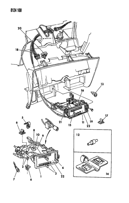

3847014 Heater Control Temperature
4443104 LEVER and KNOB PACKAGE, (Black) Heater Control
both above are levers for an M body
item # 9
I need the lever that goes on the heater case, not the control head. I'm going to convert from semi-auto to manual temp control. My servo motor went bad, again. The control heads are the same. Just have to change the lever, add the cable, and replace the servo with the lever I need. I have all the parts I need, except the lever that goes on the temp door shaft. I could probably make one, but it would be much easier the buy one. Making one would take some experimenting, as I don't know the length, or the orientation of the flats in the hole.
