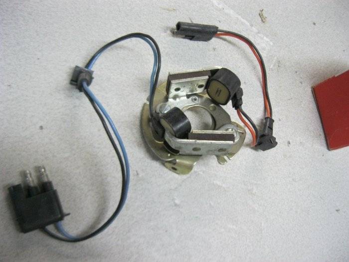

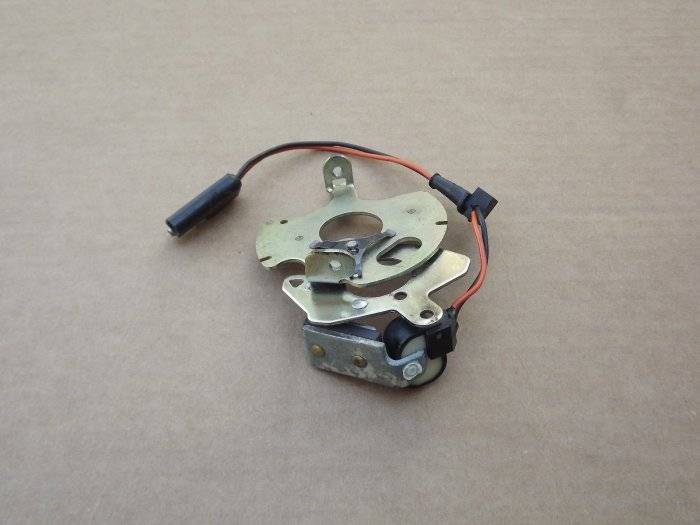

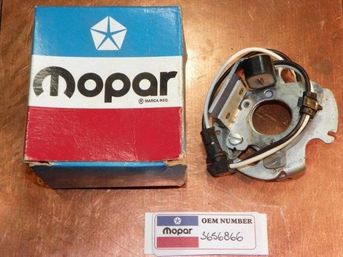

A tip on distributor pickup coils.
The ones with orange and black wires are made in USA and are far better quality than the ones with white and black wires (which are made in Asia).
The white/black wire variety will work in a pinch, but are a lot more troublesome than the orange/black variety ones are.
In the mid/late ‘80’s Chrysler quit making these distributors in USA and started to get them overseas. When they did, the wire colors changed. At same time, all distributor part quality went downhill (including the Mopar Performance versions, as well).
I “think” there is only one outlet making these pickup coils in last 30 years, and they are Asia based.
If I had a choice, I would rather use a 40 year old used orange wire one, than a white wire one – because of all of the problems I’ve seen with them.
Note: the pickup coils either work fine, are dead, or work for about 5 to 10 minutes, then dies (which the ICU can do the same exact thing).
The only way to can tell a Lean Burn/ECS distributor was made USA or Asia is by wire color.

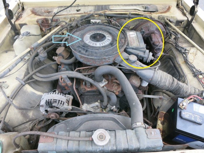

“Lean Burn”, “Computerized Spark Control”, and about another half-dozen other names are used for the computerized ignition and/or fuel system. The computer attaches to outside of engine air cleaner and looks like this:
You can even see where the name “Lean Burn” mentioned on air cleaner.
As far as FMJ-body cars are concerned, if there is a computer hanging off the air cleaner, the common term to describe the “computer system” is Lean Burn – even if there is no mention of the words “Lean Burn” anywhere.

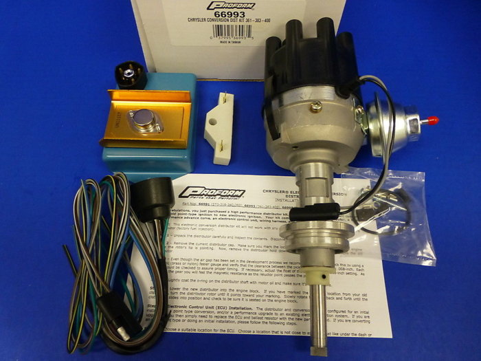

The conventional ignition change-over system looks like this kit:

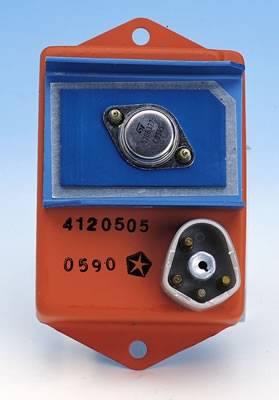

The controller can be in different colors.
This one is Orange.

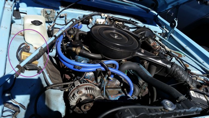

The ECU grounds through the fender well where it is attached. Make sure you are getting ground. I've always run a separate ground wire to the hold down screw. Don't ask me how much time was spent learning this the hard way.

The picture of the conversion kit I posted (post # 14) is the most common change-over kit out there – which there is several venders selling something close to it.
Basically, it is replacing the Lean Burn computer (or whatever name your system is using) with an older and simpler electronic ignition system. You mentioned (General Motors) HEI – which is also a system that can be used for changeover, but I have a gut feeling something else is amiss.
The changeover kit I had pictured (above) contains a Chrysler design ignition module, ballast resistor and a wiring harness pigtail (some splicing, and soldering is required). It also comes with a distributer that has both mechanical advance and vacuum advance – to replace the computerized distributer which uses neither version of spark timing advances (which is what the computer does when working correctly).
