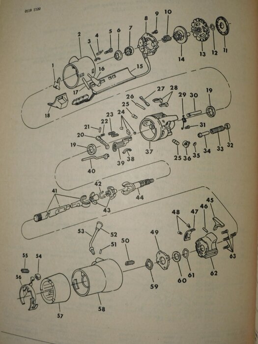

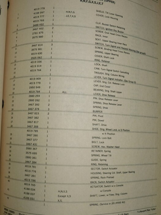

this is from an 80
Item 16 but it says its in Group8
I will dig deeper....
