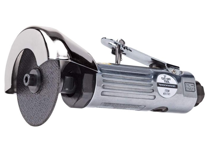

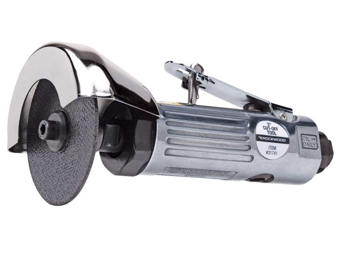

This is like the air cut off tool I have, it's about 6" long, 2 1/2 or 3" disc. The size of the battery powered ones defeat the purpose of using one that small, if they can get to something a normal size grinder can too. I do see the newer ones are at least decent rpm now then they used to be.
I can see how that would be nice for tighter spaces
