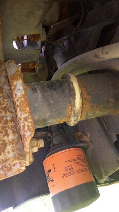

I forget who, Malcolm maybe? From Dippy.org had a screw on filter relocation kit plumbed into the pressure line on the transmission.
Brilliant idea really. The internal would never get dirty and it gives you easy access if you place it right for a flush kit hook up.
Yeah, it was Malcom. I was just telling Dad about that yesterday as he's wanting to change the filter. To my knowledge, Im not sure that transmission has ever been opened up. I was trying to dial the engine in before moving to the trans..it could probably benefit from a band adjustment as well.
Malcolms cars are at my place so I looked under them today and found one with the setup.
