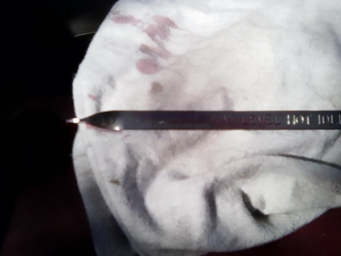

Ok so I just put a quart of transmission fluid in, that got the level up to the Ok line (see picture) i cant afford any more at the moment at $12. a quart (fucking price gougers) I'd already warmed the engine up, so the idle wouldn't be high, so I put the quart in and put it in neutral like you said, moved through the gears (with foot fully on brake) and checked it, it was low again, around this time neighbor sees me, and gives me an extra quart he had lying around, wasn't a full though, but put it, still needs more to get back to ok, so I'm waiting on some cash...so I get buy another quart and fill it up and go from there IMG_20250318_145853.jpg
OK, the important stuff here is to always check the level in NEUTRAL as that circulates the fluid around so you basically get an equivalent of transmssion being in use.
It matters a bit that the fluid is supposed to be checked when HOT, that will cause it to expand a tad, but we are not talking massive amounts here.
For now, continue on doing what you are doing, but sneak up on it so you do not end up overfilling it.
Each time you check I would go through that quick: Neutral, shift to each gear for about 10 secs and back to Neutral then do the check, cycle.

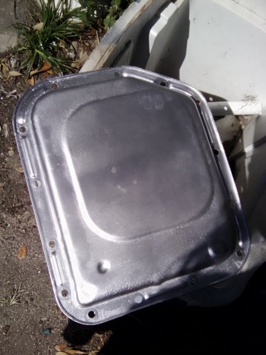

Neighbor is changing the fluid and filter (also radiator) there was a lot of gunk at the bottom of the pan, and filter covered in sand (from the pan being so loose) but very little metal on the magnet, pan is clean now and outside painted sliver. Man I'd like to sue that garage that replaced it last and just finger tightened the boltsIMG_20250326_152744.jpg
