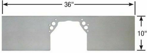

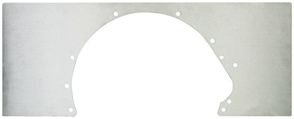

Either that or directly tie the engine to the chassis:

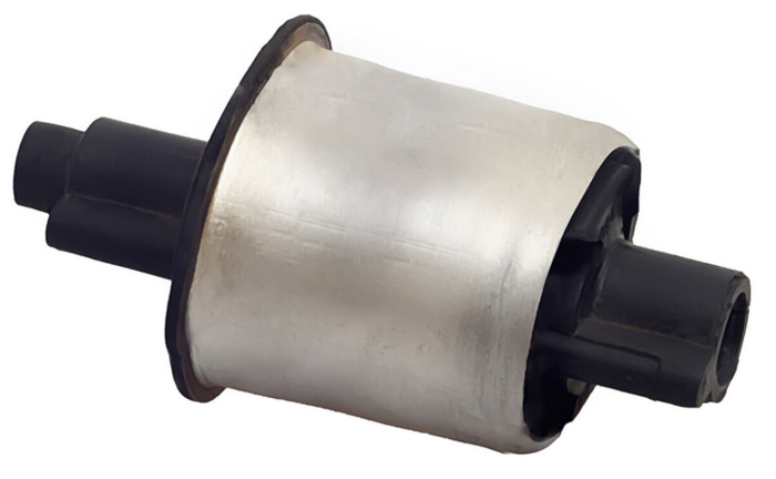

The only thing that might make a transmission mount hard to find is some FMJ mounts have an extra (welded on) exhaust mounting bracket - which might finding the correct mount hard to find. About ten years ago (or so), I bought a few transmission mount inserts - so I could reuse my existing metal transmission mount frame:
I have yet to install an insert, but have heard from friends they can either be easy to install, or a royal pain (mainly getting the old metal shell removed). Now transmission mounts, in general, I have replaced a bunch of in my life - but some of the transmission mounts specific to a few FMJ's are getting hard to find.

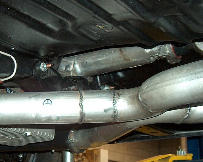

Aspen500 brings up an excellent point about those weights that you'll occasionally find here and there, that by all accounts seems to just "weigh the darn thing down"...LOL!
I moved to a poly transmission mount when I built my coupe. I also removed the trangle (or half-doughnut shaped) weight that was attached to the tailshaft housing. It wasn't so much because I was trying to shave some weight off, rather I was putting an X-pipe exhaust in place and that spot was the best-fitting spot to place the X-pipe section in.
Anyways, I also have this high-speed resonance, you can easily tell that is precisely what it is as well. Subsequently I put the re-installation of something to damped that vibration with on my To-Do list. If anything at best it may help/cure it, at worst it does absolutely nothing and all it had cost me was some time to implement.
Here is what that setup looks like right now:
