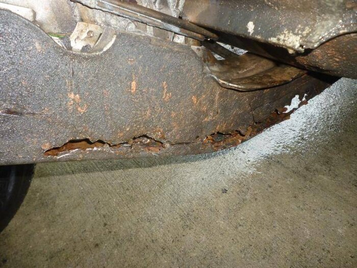

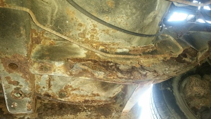

The big thing is to check the frame rails for rust. Get under the car (if possible) and bring an ice pick or small screwdriver and start poking. The front and rear frame rails can be repaired or replaced (the newer M-bodies are a great source for core body parts) - but is a lot of work.
L/F Frame rail (or whats left of it).
R/F frame rail (another forum member).

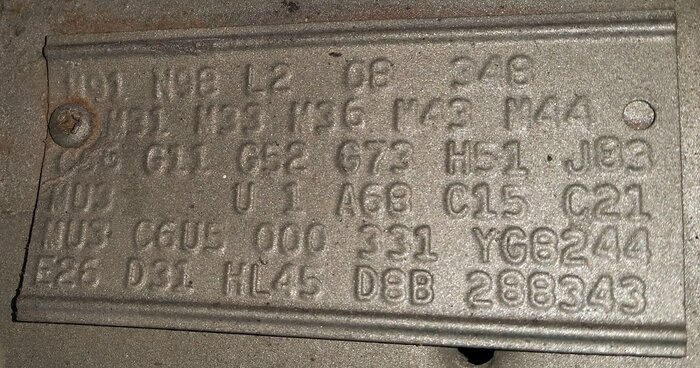

If you go looking for an FMJ, I would look up the engine and transmission fender tag codes before hand (or take a picture and post here). A quick look will tell you which transmission and engine the car came with.
I looked at this car a while back for a fellow forum member, a few years back. Without even looking, I can tell this car is a '78 Volare (Low trim level) Wagon (45) with 225-2bbl (E26) and A904 (D31).

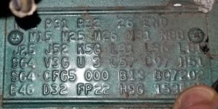

This is another forum members fender tag. This is a '79 Lebaron (High trim level) 2 door (22) with a 318 4-bbl (E46) and A998 (D32).
If you are not familiar with the A998 - it is a stronger version of the A904. The A999 is a stronger version of the A998. Not many FMJ's came with the A727 (mostly special ordered cars).
