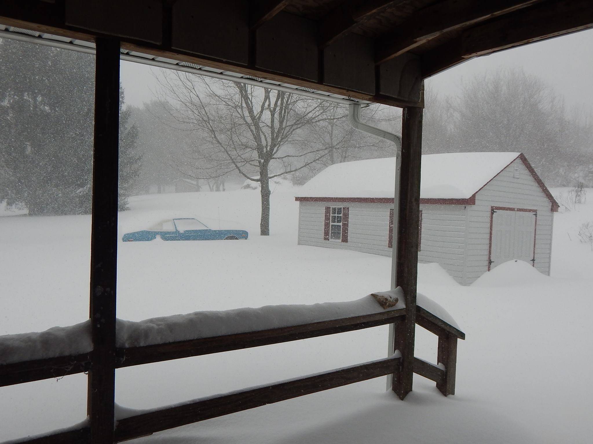

This is the Volare today :( I don't have a cover or garage space so it sits out in the snow. Ah well, we're planning on having it repainted anyway, I just hope snow and meltwater don't get in too much, the weather stripping is cracked and needs replacing.

Fear not. I'm sure she'll be fine. You can start dealing with the fallout from winter in the spring.
Yeah, I'm just concerned because I know how easily the '76 rusts. Though I'm sending it to a tech school to get the body work done some time in the future, let them deal with the rust. I don't have a welder anyway. The undercarriage actually looks remarkably good, most of the rust is on the body.
Just take your time and fix it up as you can. If it's only that rusted in 40 years, a few more years aren't likely to make that big of a difference. Nobody likes rust, but we've all seen MUCH worse. Really pretty little coupe!
Nice !! .... yeah, I think it's better to keep it frozen rather than the freeze melt cycle we have here .. but garaged is best.
