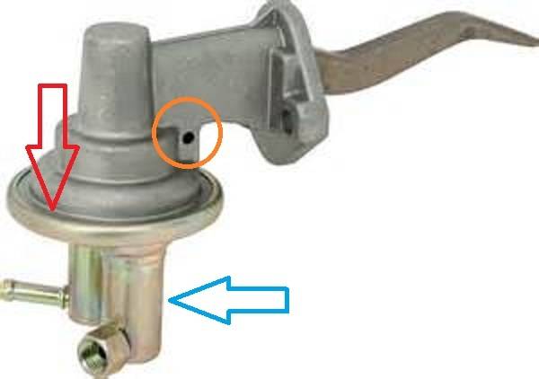

This is what a stock small block fuel pump looks like.
There is a crimp where the top half and bottom half attach – which also holds the edge of the diaphragm in place.
A poor crimp (red arrow) can cause a fuel leak, an oil leak or both.
The orange circle is to be a diaphragm vent and it can leak fuel, oil (or both) – if present (not all pumps have that vent).
The blue arrow is where the check valve(s) are located at.
The stock pump is not serviceable, except as an assembly.

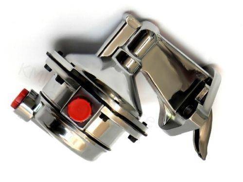

This pump is rebuildable. Also, you can remove the screws (to middle to top or middle to bottom, to clock both the inlet and outlet fittings, as needed. Both the check valves and diaphragm are replaceable.
To date, I have not been inside of one of these pumps yet. I have clocked the fittings before – but not gone any further than that. Also – I hadn’t seen one of these pumps go bad yet (to date).
On the other hand – the stock appearing fuel pumps, I have replaced by the hundreds. I don’t know if the rebuildable style is worth the additional money – but does appear to have a better track record.
Also note: most of the performance fuel pumps/cars in the 60’s did come from factory with rebuildable style fuel pumps (including early 340’s).
Edit: the lower picture is for a big block. The pump is the same except for the arm (which is much shorter).
