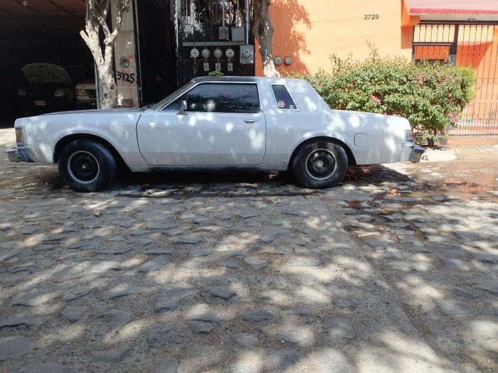

I left my 1980 Dart (yes Dart, Mexican car) without use for a week, today i tried to start it and got no spark.
