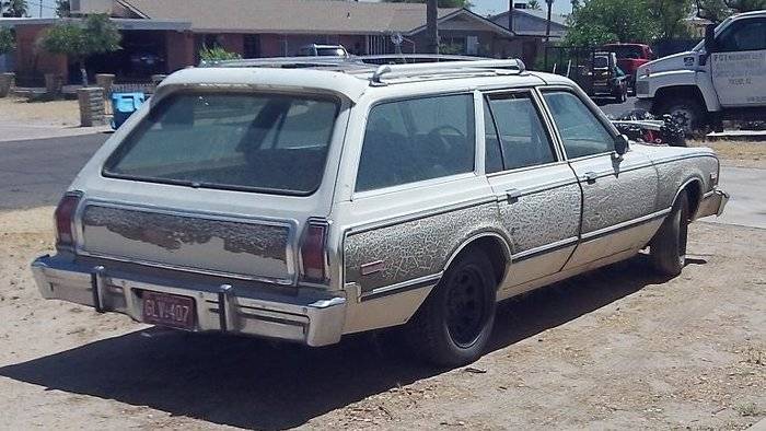

Need the woograin border trim for a 79 volare wagon. Will buy any pieces. I need it in the chrome style not the wood

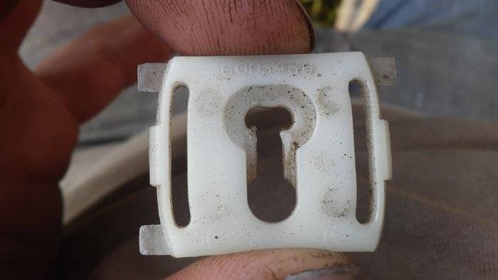

I did source a very nice set from quebec but i appreciate Jim. I am in need of the clips for it though. Mopar 6003486. If you had any of those ill take em

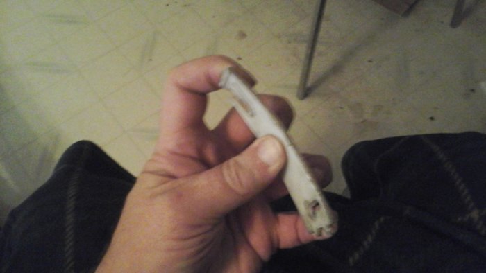

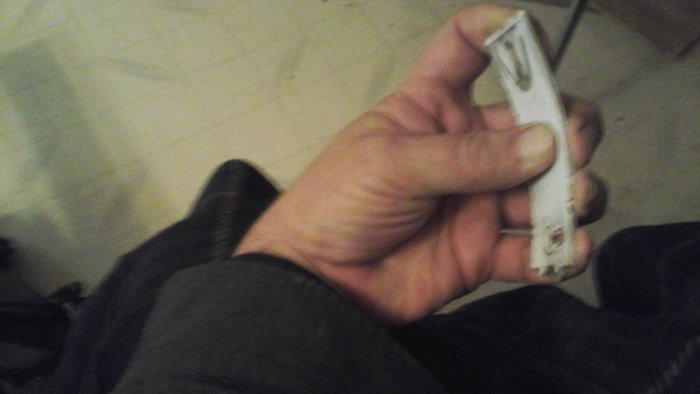

BOIL THOSE CLIPS!!* I just exposed the top clip to 6 minutes of rapidly boiling water, water temp was about 250F. The 2nd photo is of a similar 30 year old clip un-boiled. The improved flexibility is in-your-hands evident even after it has sat and cooled. I've had good experience with restoring headlight adjuster plastic this way as well. If you have clips of this type of material, boil them first before reinstalling them.
*Always test to make sure the material doesn't melt.
