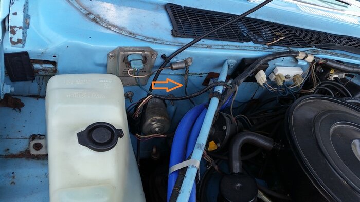

The voltage regulator and ignition module both are effected by a "possible / likely" poor ground. Some regulators use bare metal but many (as well as all ignition modules) use painted steel surfaces.
Paint (on regulator, on ignition module and on firewall) is an electrical insulator. Also rust/corrosion also is a poor electrical conductor.
Sometimes removing the two fasteners, taking a wire brush to the bolts, the module and/or firewall, will give you a good ground.
Also, making a short ground wire from one of the mounting bolts to firewall ground will also help.

This has always been a problem sense these cars were built. A little elbow grease and a wire brush does wonders.
