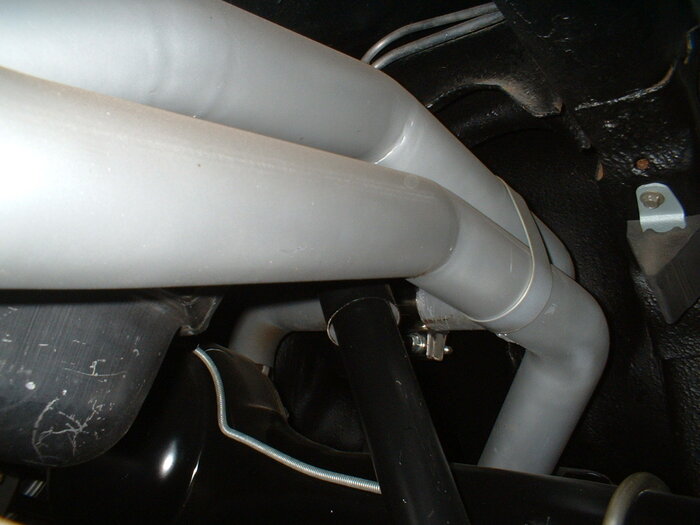

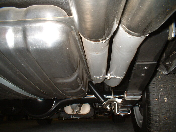

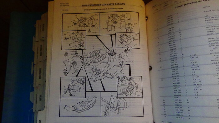

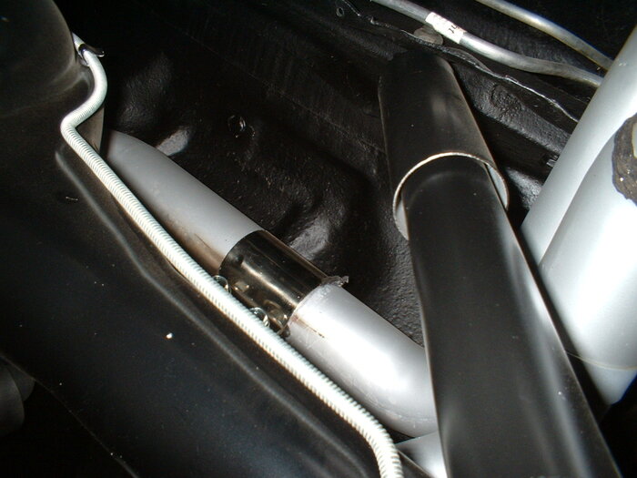

The 360 E58 F and M body could be had with dual exhaust where the "Y" was over the rear axle. The left t-pipe goes up, then across to meet up with the right t-pipe and then to a single (larger pipe I believe) t-pipe with a resonator. No idea if it was standard on the E58 or optional.
I kind of modeled the exhaust on my car after that except, it's 2 1/2" all the way with dual 2 1/2" t-pipes out the back. It was tight and lots of work but I managed to make them clear the spring and fuel tank,,,,,,,,,,,,,,just. By "just", I mean 1/8" from the tank flange and 1/8" from the spring shackle.
Last pic is from the '79 parts catalog.

Super Helpful Aspen. Thank You. I was trying to conjure how the "Y" pipe would be in front of the rear axle, but obviously it goes between the fuel tank and axle..
I'm debating headers vs manifolds, then I think the rest of the system will imitate what Mopar did, but with modern materials and techniques.

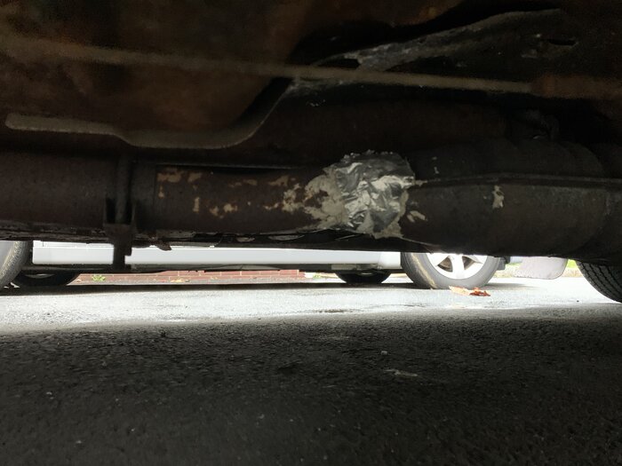

lucky you guys, I had to use furnace cement and aluminum foil to plug up holes in my pipe!
check out my "custom" exhaust!

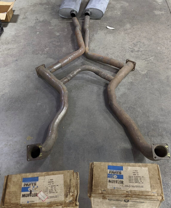

Just because I recently saw this and this post made me remember it. This NOS max wedge exhaust was posted by a restoration shop I follow. I can’t image a single pipe max wedge car in my head, but someone could do it/have it done pretty easy.
Those guys are pretty straight forward with their numbers and results. If they say it’s a better position further back than up front from their testing, I wouldn’t doubt it at all.
