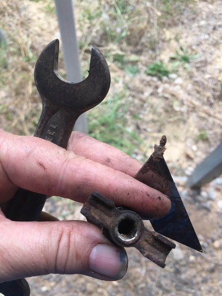

17. Some bracket I don't know what the heck it is for and only sorta know where it might go
I'll add a picture of the mystery bracket.
I don't think I need it, but if someone could post a parts page I'd appreciate it.

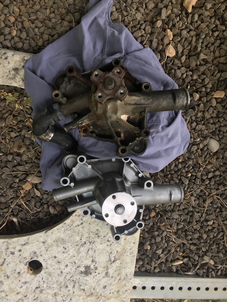

Cleaned off the mating surface for the pump -- yuck. Most of the gasket was gone.
Compared the old pump to the new pump. Oh lordy lordy.
Old pump would turn by hand but it was a bit gravely when it rotated.
It also felt like it was rubbing metal on metal, as if it had no orings in it.
Made me feel like I made the right call last week by ordering these parts (water pump, fan clutch - heavy duty although it didn't seem any more heavy or durable than what came out, and a new radiator cap with the cute lever so it can easily burp.)

But I'm concerned I don't know if I should put this last mystery part back on or not.

Not sure what your cooling requirements are, but is this a 'like for like' pump replacement? My point being, you could always source and install the HD pump, or at the very least one that has a higher impeller count. This approach will help the pump move more water while the HD pump has a thicker pump shaft I believe.

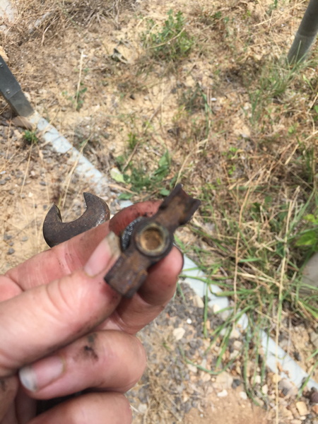

Mystery bracket..
I think this was sitting horizontal across the two bottom bolts on the water pump. Guess I should have turned the picture 90 degrees.
The only shiny place was the two bolt holes, the cylinder was not shiny inside or out. As if it had a purpose that was not in use on my chrysler.
I did not put it back on.

Old pump above, new pump below.

I was told that bracket is used at the factory for checking the timing, or rather to hold the tool that checks the timing or something like that.

it is the magnetic timing pickup holder for the ELB diagnostic tester, it was use to time the engine at the factory. Your replacement pump is the heavy duty/large bearing pump, all A/C, and heavy duty cooling cars should have them.

So it sounds like as long as I don't plan on learning to time the engine, that little bracket is not going back on and should not adversely affect anything.

...Your replacement pump is the heavy duty/large bearing pump, all A/C, and heavy duty cooling cars should have them.
Great point 80mirada...if I can add something to the above it is the following: easy way to distinguish the standard from heavy duty pumps is by looking at the housing where cooling fan/clutch attach...if the housing has the shape like what you show it's the HD, if the housing has 'pipe' like casting, that is the standard pump...LOL, heck, I wish I had a picture handy to show this...my description above is not very good...I tried....

You would be hard pressed to find a usable magnetic timing tool nowadays. I do have a buddy that has the original Mopar ignition testers, including magnetic timing probes, in near perfect condition. We still used a traditional timing light to recheck the timing.
There are actually three different style water pump castings for LA style (small block) mopar V8s, now. I will see if I have pictures of the other two.

A good many of those timing brackets "vanished" back in the day. Usually when the water pump was changed or the front of the engine was opened up, the magnetic timing deal never went back on. No reason for it. Timing is done with a regular light and the markings on the timing chain cover.

M_Body_Coupe --
If it looks fluted like a bundt pan then its heavy duty,
if it looks smooth like pvc pipe then it is NOT heavy duty.
