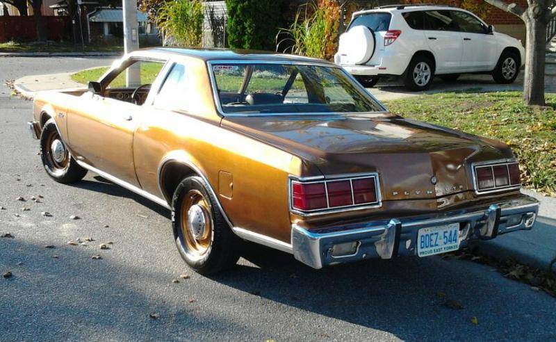

M body police units used 215/70-15's. Same tire diamater as the 205's and fit perfect on the stock steel wheels. I run them on my 5th.
My 1986 FSM says 205 75 R15
But, I run the same as Eric... 215 70 R15 on both my M's
They look good.
