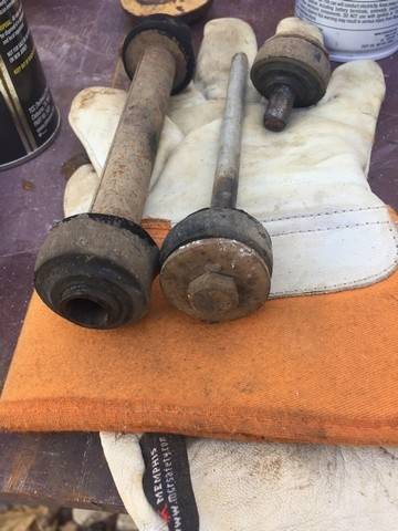

I found these two items in the drive (1/4 mile) on my walk this morning.
They are not quite as long as a glove The one on the left is an empty tube. The one on the right looks as if it sheared the end off; however, it also seems as if the sheared off piece has a thicker shaft than the long piece.
Could this be something off the chrysler (changed the tie rods recently)?
I've also trailered a 1964 Willys pickup down the driveway.
Is it something off a floor jack?

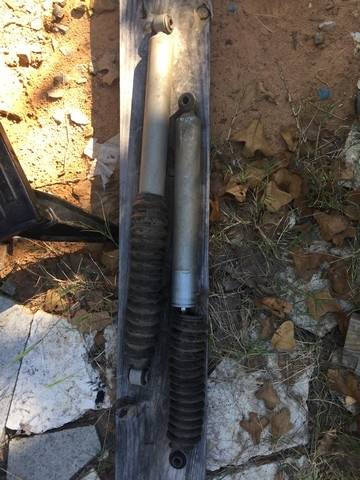

Something off the Silverado truck (changed the rear shocks recently)?
Here are the old rear shocks - they don't look like they are missing parts.

that sounds important.
Sway bar is near the tires so I'll get a flashlight and go look under the vehicles.
Then I can quarantine the vehicle.
3,783
1,148
Its the silverado.
Passenger front sway bar link is gone.
Driver's side front sway bar link is there.
Do I replace both at same time or is this a rare thing?

You may as well do both at the same time. In fact, a lot of them come in one pair to a box and no, sway bar links breaking is not a rare thing.
Up here it's the rust that makes them fail. If you replace only the broken one it's a guarantee the other will break within a couple days, now that the sway bar is hooked up on both sides again.

Most sway bar end links use grade 5 bolts – which is fine for most drivers.
My driving requires grade 8 bolts – to keep that long bolt you had, from breaking.
New bushings and a new bolt(s), would have been all you needed to fix that truck.

Are you saying that I could have gone down to the farm coop and just bought bolts and bushings?
Yes, you could have (and saved a few clams).
You were lucky and it doesn’t appear you lost any of the washers or other hardware.
Just get a correct length bolt (Grade 8), for each side.
I don’t think the type nut matters but I would get nylon lock nuts (to keep rust/corrosion down).
Reuse all of the metal parts. The rubber bushings could be reused as long as they are not ripped, broken or missing. Then attach with new bolts.
If you lost parts, then you would have to fabricate something or go get a new link kit,
More than likely, those parts fell off at different times – maybe even as much as a span of a week.
Note: rubber bushings will do you and your family just fine.
Poly bushings are more stiff and can make car handle better for those who stress there car more often (OK, like me) – but poly bushings cost a bit more.
Sway bar end links and bushings is an item that will wear out or break on just about all vehicles out there.

Sad story.
I had to replace the new passenger sway bar link today.
Why?
Because I didn't get it torqued enough.
Found parts of the new one on my drive way during my regular walk.
Sigh.
Missing the barrel nut and lower 2 bushings. I found one bushing and sleeve.
And of course, the new bolt is bigger than the old bolt.
