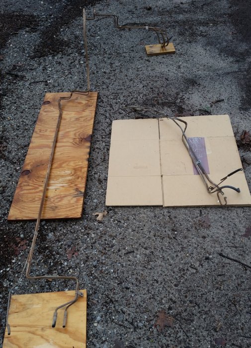

- Crimped off and/or rusted-through fuel lines. Having some minor damage or rust on metal lines doesn’t mean you have a problem. To check for rust-though – what I do is get a small screwdriver or icepick, and poke where I see rust. If your “poker” goes though or makes a dent – then you have some line to get fix. There will be three different sized lines going from fuel tank to engine compartment (5/16”, 3/16” and ¼”). Two of those carry fuel, the other one carries fuel vapor (to charcoal canister). You don’t want any leaks in either of those three lines.
- Cracked or broken fuel hoses. There are 3 pieces of ¼” fuel hose, 3 pieces of 3/16” fuel hose and 4 pieces of 5/16” fuel hose. Sometimes a “air leak” at a hose (or line) is worse than a “fuel leak” – because it takes so long for fuel pump to get anything moving. Fuel pumps do a decent job of moving fuel – but an extremely poor job on moving air (sucking air, to be more precise).
- Bad fuel pump
- The least possible item would be a stopped-up fuel filter (by engine). The in-tank filter can cause this – but it will give tell-tail signs of fuel restriction at last time car was driven.
the guys at the box store tell me I should use metal brake line for fuel lines. Is that true?
Gasoline line from fuel tank to fuel pump is not under pressure. It is under pressure after it leaves the fuel pump and that pressure (between 4-8 PSI) is not much. Rubber is not recommended for long distances for a number of reasons.
Any metal tubing will work – but avoid anything that is affected by alcohol. Mild steel was used from factory. I prefer stainless steel for fuel (and vapor) lines – but it is a tad more expensive.
Metal fuel lines come either straight (the best to work with) or coiled. Coiled takes time to straighten out, before use.
Some inexpensive metal tubing bending tools can make metal line bending a breeze once you get some practice in. YouTube has some good fuel line bending videos to watch.
Fuel injected cars have a lot higher PSI – and might require different tubing.
Brake line is designed for high pressure (tens of thousands of PSI pressure) and is a bit of overkill for fuel line.
I have plans on replacing the 5/16” main fuel line with 3/8”. I already have about 200 feet of stainless fuel line (coiled) to play with and an example to model after.
Also, I’ve spent a lot of $ getting some Eastwood tools ( https://www.eastwood.com ) for my fuel/brake line bending, including making beads/flares on fuel lines (not needed for low pressure lines, but is nice).
All I need now is time to get it done.
