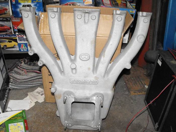

You can get 4 bbl. intakes through Offy or Clifford. I don't know if Doc Dutra is still doing the hyper pac manifold. I think an Aussie Company still is along with Clifford also. The Aussies have lots of parts just do your research as there is one shady character out there. I know from experience. The Super Six set up is still availble through e bay or the classifieds.

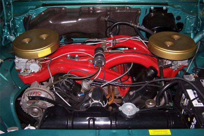

Back in the early ‘60’s Chrysler had come up with the long ram intake system.
Ram Theory
A variation of that was the short ram intake – which at first appearance looks like a long ram.

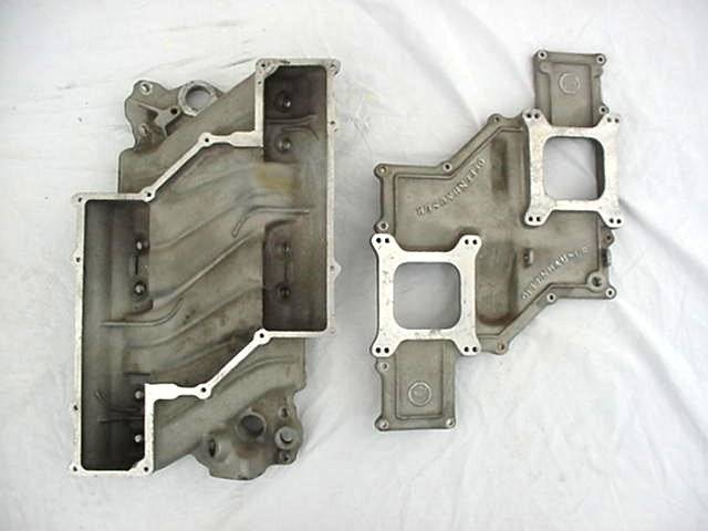

First is the long ram intake. I already have a set of aluminum long rams and would really love to install in my big block 5th Ave – but suspect it won’t fit.
What I would like to do is make a set close to it that will have a pair of throttle body’s on it (one per side) and 8 fuel injectors (one per runner).
Those intakes have four pairs of runners.
The difference between the long ram and short ram is the internal divider length (about ½ the distance at 15”).
The long rams - the tubes went the whole distance. These stop mid way - which you can see.
My thought is to make a plastic version of same intake and have 2 plates in it per tube pair (8 total). Already cast into the plastic is a 7½” (to middle of intake valve). Have a 7½” plate that either rotates or pops up to have a 15” runner – then the last plate, which will be 15” long) that will either rotate or pop up to create a 30” runner for low end power.
