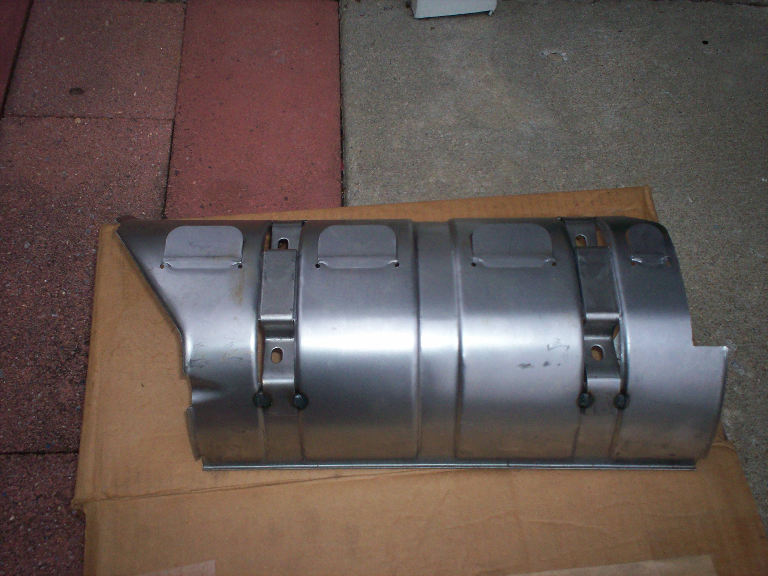

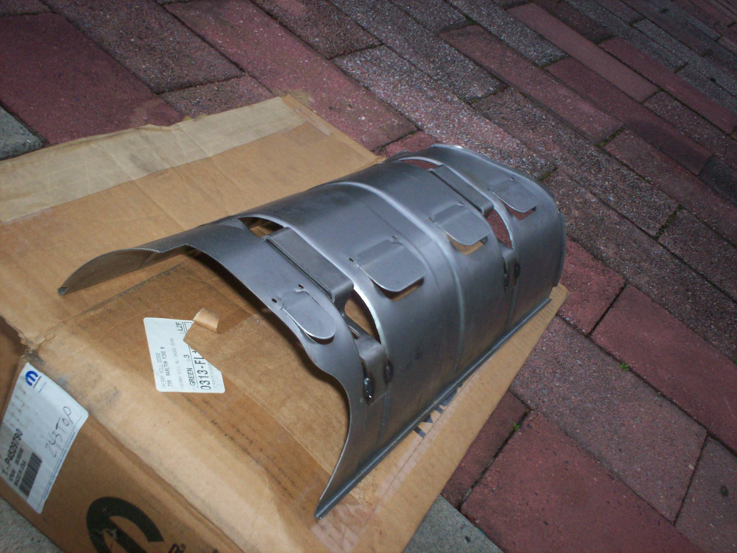

This was a new in the box item and a $40 find. Gator's 340 is gonna need this insurance as he punishes it like politician that won't shut up.
2,978
697
The seller had a few other mopar items. Such as used Super Comp Headers - $60 bucks, Fairbanks trans shift kit NIB -$40, 360 Magnum head gaskets NIB $30, Magnum 360 to 904 flexplate- $80, and this one is for Gator- Mancini trans to throttle cable NIB. Which means any return visit will be with more cash.

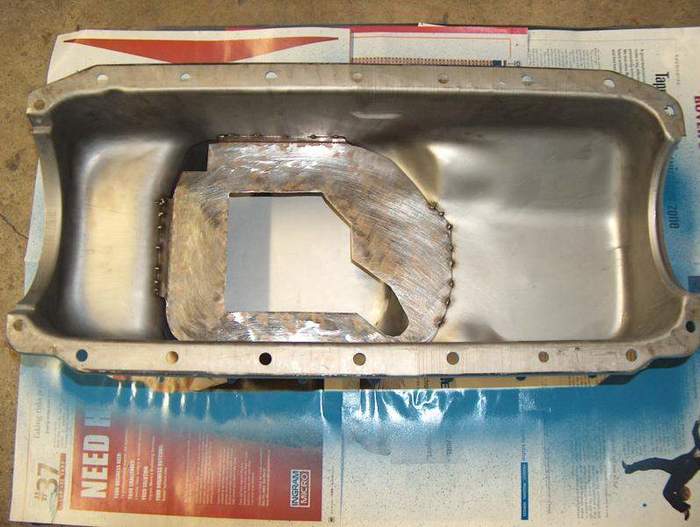

I spin my 360 motor to 6500 each WOT shift, used to do that with my old build as well...both motors ran a windage tray, while the current one has a welded in "separator" plate as an attempt to help keep the oil pick-up tube covered and minimize the amount of oil slosh in the pan:

That's how the pros do it. They will generally use a deeper pan sump with baffles to keep the oil far away from the spinning bits. They may use a scraper as well, but not the type of windage tray we're used to seeing in stock applications. Regardless, I still strongly suggest using one, especially if--like you--the owner likes to spin their engine into the perma-grin zone. :D My 340s spent a lot of very happy time north of 7,000RPM with no ill effects.
