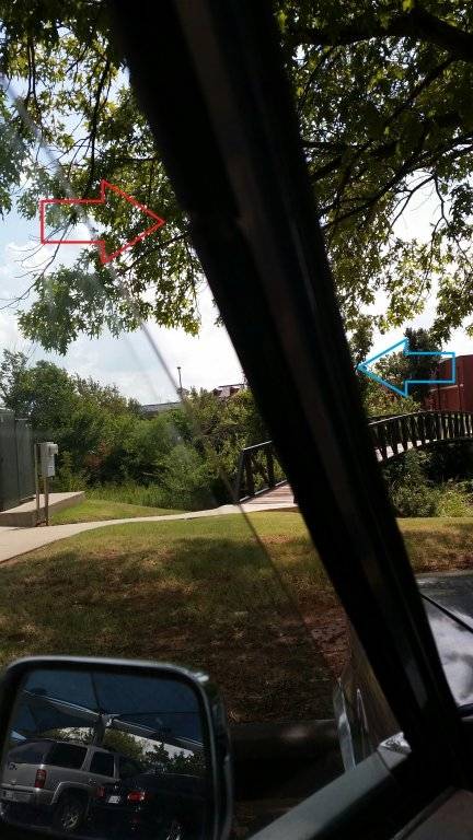

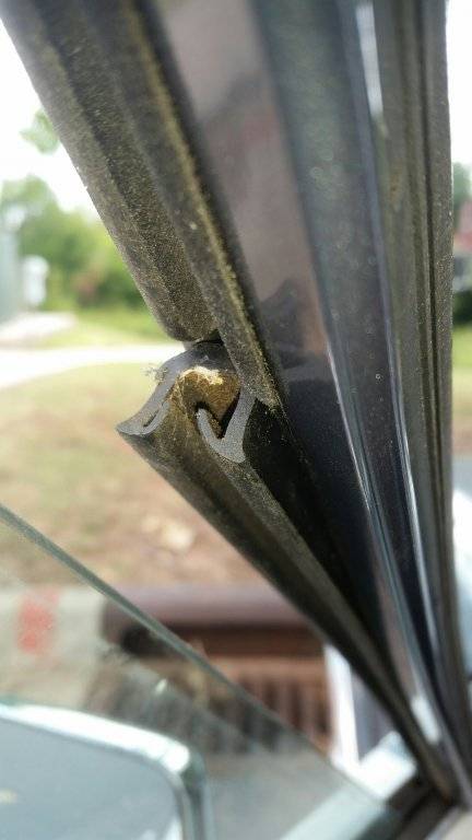

Pictures of part on my 5th Ave. I suspect your rubber/felt part is rock hard as well (but I’m not sure). The RED arrow is the part that goes around the glass and in this case, is showing where mine is broken at. You can see the profile of the part in second picture.
The BLUE arrow is showing the weatherstripping that goes around the perimeter of the door
These pictures were taken at my place of work.

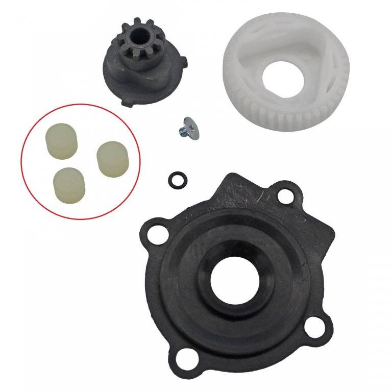

The motor part of the windows can and do fail, but the plastic gears inside of them break a lot more often. The gears are reasonably cheap and easy to fix. The motors fit darn near anything in that time frame and are fairly common as well.
Picture swiped from eBay.
The item in the red circle, there is a thread about replacing those with nuts with corners rounded off – which I plan on doing on my next window motor repair.

Good choice to use the proper plastic/nylon spacers. I did my drivers window a few months ago and it works great.
1,492
I’ve always used the plastic spacers/inserts and I know why they are there for.
That said I have gone through quite a few of the plastic gears over the years and figured I would try it this time to check it out.
Those spacers crumbling is what causes all of the problems on those gear(s).
Actually, what I was going to try is copper tubing or something like that of the appropriate size.
My L/F window works except for the last ½” then it starts popping.
