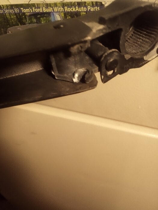

The spring broke on the passenger side windshield wiper arm, would an '88 Plymouth Horizon wiper arm work?

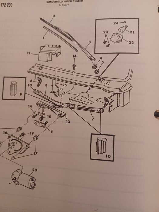

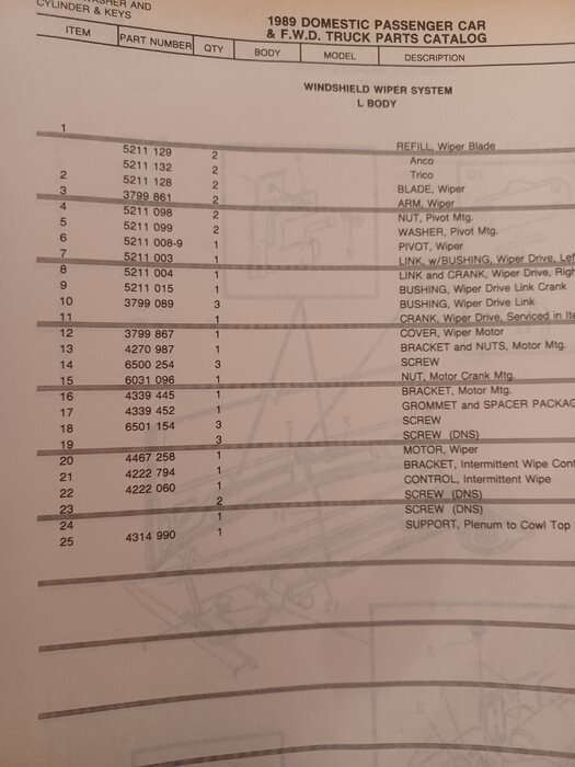

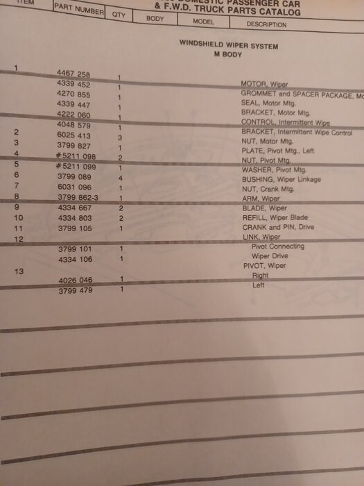

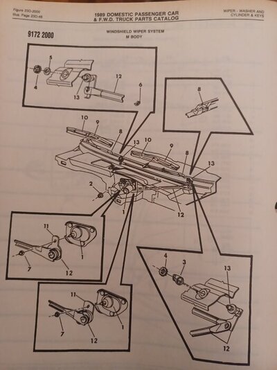

Horizon part numbers and diagram for 88:
M body for 88:
It says the nuts and the washers on the passenger side are the same part numbers, so it might bolt on for quick fix. Might not.
There are a lot of Volare arms out there. I wonder if the Volare wiper arms would bolt on

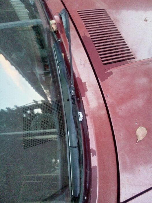

The answer to the $6,000. question is: Yes, a 1988 Plymouth Horizon windshield wiper arm fits fine on a 1985 Plymouth Gran Fury! Now where I pick up my $6,000. from?IMG_20231108_173658.jpg
