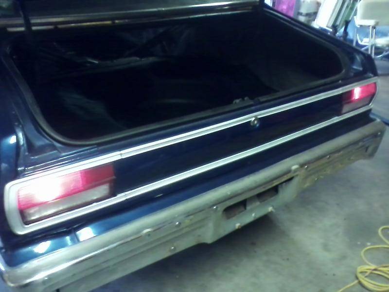

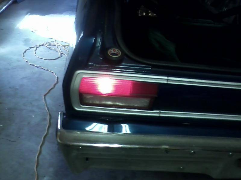

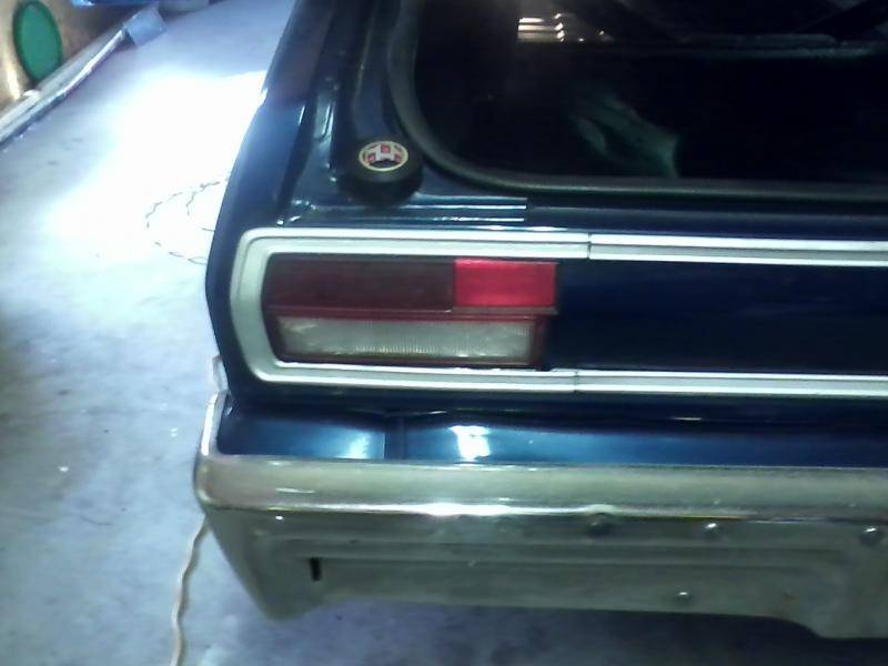

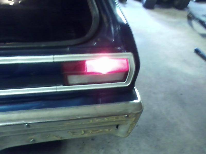

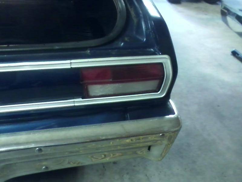

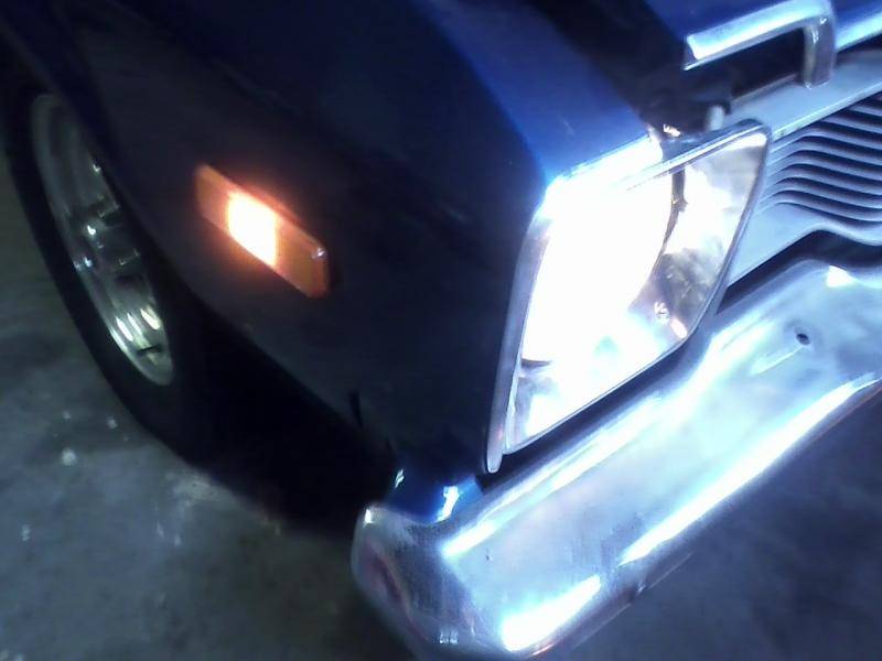

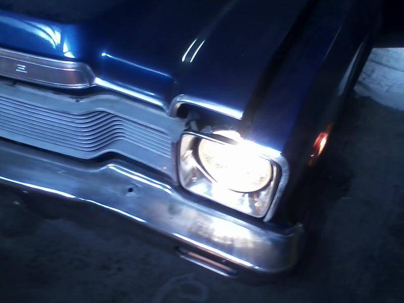

Let There Be Light Wiring All Complete
My main focus has been redoing and fixing all the in dash wiring which has been truly time consuming and a real pain in the ***. The dash is complete now. I went ahead and replaced all wiring in the rear that was burnt corroded and melted. We have all working lights now. All wiring is finally complete. :icon_super:
