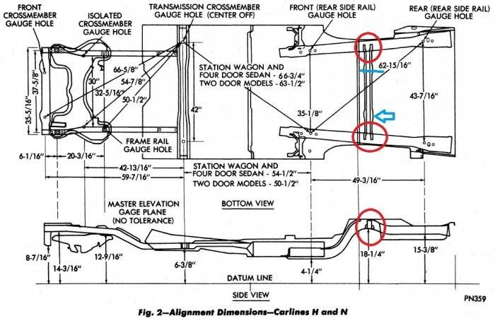

Air springs work, but the body mount piece of sheet metal (crossmember), doesn’t like the extra stress of air shocks. I have seen that rear upper shock mount fail on several cars that had air shocks installed. Where it fails is almost always where the body mount connects to the frame rails – and generally is not an easy fix.
The red circles are the (only) places the body mount attaches to frame rails (or anything, for that matter). The blue line/blue arrow is where the upper shock bolts are at.
If a person was top reinforce that upper mount, I would find a way to attach the mount to the trunk pan on top as well as weld in struts to the lower half of that mount. What happens is that part starts to twist in place until it separates from the frame rails.
Now, I have seen it happen a few times and only with cars with air shocks. I’ve not seen it happen with normal shocks. I have also seen several cars with air shocks without troubles.
If I was dead-set on using air shocks, I would reinforce that mount – or also for extreme usage (all out road racing).

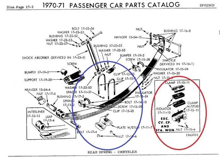

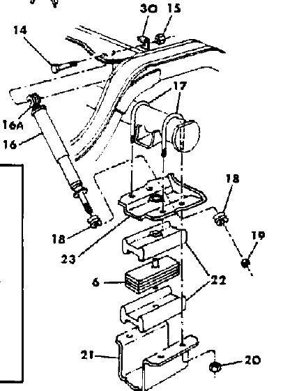

Removing the Iso-clamp will also raise the car up by about ½ inch (13 mm) or so.
The first picture is from ’72 parts book, I think.
The second pic is from ’82 parts book.
The second pic, item # 22 is the rubber biscuits that insulate the road and makes the car fleet soft. Also item # 21 is the weak link. If it breaks, then that corner of car is dragging the ground.

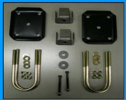

Firm Feel makes a delete kit that reuses some existing hardware (reuse old shock absorbers).

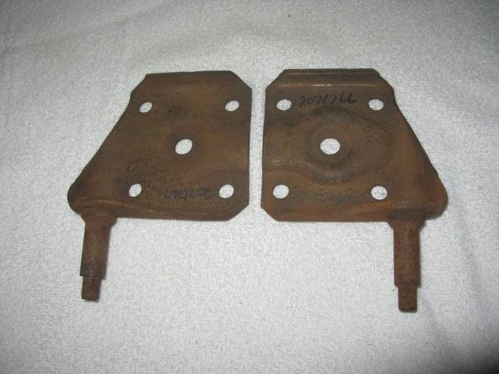

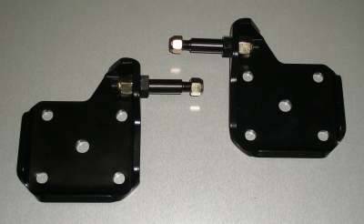

I recommend finding some ’60-72 shock plates (and new U-bolts). Some people are making them new. They will require different shocks because of the rear attachment is different. The shock length is the same. Just look for say ’70 B-body rear shocks and they will fit fine.
Aftermarket New
Used
If using the older shock plates, you will need to have “normal bolts” re-installed (when getting old springs re-ached at spring shop) instead of the Iso-clamp wide version (they will reuse old bolt – which won’t work with older shock plates).

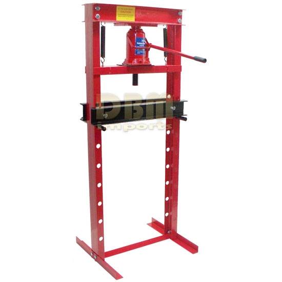

I have done them myself. You will need some clamps and a press.
Plenty of YouTube videos that be better to watch - than to have me explain.
Spring shops have a specially made press which is slick to use.
A lot of details on Jeep leaf springs, but the same exact process as FMJ cars.
In summery
If doing yourself, find a flat floor, garage or driveway. Lay spring down and make a chalk outline on one side of spring. This is your baseline.
If raising rear of car up say 2” (or whatever your goal is) then once done, your spring will be 2” taller from your baseline on the ground.
Using clamps, take spring apart. New metal bands are available, as well as bolts. Sometimes you can reuse both.
Each leaf will need to be bent separately. Put spring in press and bend it every 2-3 inches or so. You are not bending it much – and it takes a while to figure out how much to bend it.
