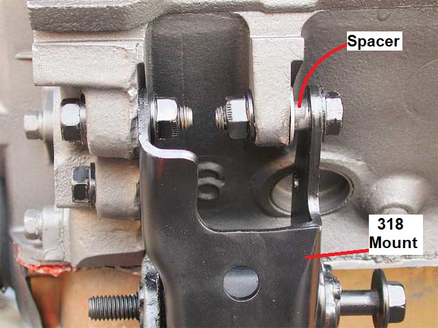

As mentioned, all you need is a spacer to make up for the 360 mounting lugs which are closer together than the 318 lugs. Don't forget that the 360 is externally balanced and requires either a 360 balanced torque converter used with your stock flex plate or a 360 balanced flex plate used with your 318 torque converter. This photo came from the old Motor Trend Stealth Bomber article.

Reggie is, as always, spot on.
I will say this: for my liking I would prefer to use some nice thick washers to give that mating area a larger surface 'connection'. There is something about that thin little spacer in this installation that just doesn't put my mind at ease! lol

I agree. I would opt for washers or a solid spacer to support for that rear block lug - especially with a well built motor.
